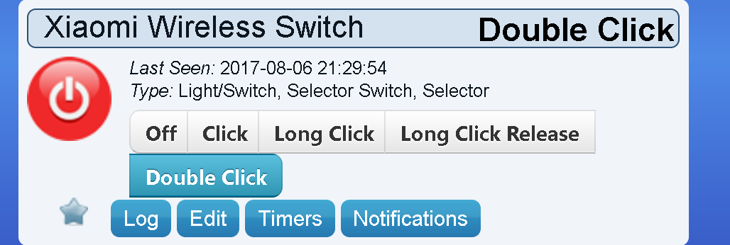

With new beta v3.8240 all my 4 wireless switch when i use "DoubleClick" Domoticz set "LongClick".
I have to change all my Events or there is a method to fix?
deennoo
Posts: 784
Location: Bordeaux France
Post by deennoo »
We have to do this to add the square wireless switch, please change your script...this change was made for been on stable version. Using beta before is thé risk that changé have to be done.
http://domo-attitude.fr
joebar
Posts: 35
Joined: Tuesday 24 January 2017 12:19
Post by joebar »
Andree wrote:With new beta v3.8240 all my 4 wireless switch when i use "DoubleClick" Domoticz set "LongClick".
No Andree, it can be done much simpler.
Go to your switch, press edit and look at the selector levels.
The new sequence is off, click, double click, long click and long release.
Yours will be different, just reorder them using the arrows at the end of the level name.
Couple of clicks and you're done.
Don't forget to save the new sequence.
