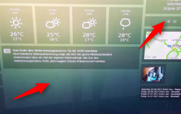

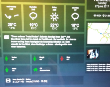

Hi for some reason I try Dashticz on 55 inches screen by HDMI and with seperate raspi, but all selector switches are not displayed as on my normal WIN-PC screen. Also sunrise and sunset symbol are not there. Any idea?

vgr2 wrote:Hi for some reason I try Dashticz on 55 inches screen by HDMI and with seperate raspi, but all selector switches are not displayed as on my normal WIN-PC screen. Also sunrise and sunset symbol are not there. Any idea?
Do you get any error in developer console?

robgeerts wrote:
Blueone wrote:I skipped a few beta versions but yesterday I installed the last version, for some reason is doesn't go to stand-by, is doesn't even hits the stand-by function in main.js. I now reverted to the previous version where is works normally. Does someone else also experiencing this issue?
I have some errors.....
jquery.min.js:4 Synchronous XMLHttpRequest on the main thread is deprecated because of its detrimental effects to the end user's experience. For more help, check https://xhr.spec.whatwg.org/.
send @ jquery.min.js:4
ajax @ jquery.min.js:4
(anonymous) @ (index):46
jquery.min.js:4 GET http://admin:[email protected]:8080/ ... 8754069309 401 (Unauthorized)
$.getJSONP @ VM49:142
getDevices @ VM45:775
(anonymous) @ VM45:174
i @ jquery.min.js:2
fireWith @ jquery.min.js:2
ready @ jquery.min.js:2
J @ jquery.min.js:2
VM45:779 Domoticz error!
Please, double check the path in _HOST_DOMOTICZ-variable!
error @ VM45:779
i @ jquery.min.js:2
z @ jquery.min.js:4
(anonymous) @ jquery.min.js:4
jquery.min.js:3 Resource interpreted as Document but transferred with MIME type image/jpeg: "http://192.168.178.26/zm/cgi-bin/zms?mo ... 8754134996".
attr @ jquery.min.js:3
K @ jquery.min.js:2
reloadIframe @ VM45:684
(anonymous) @ VM45:645
contentscript.js:88Uncaught Error: uBlock Origin: aborting content scripts for http://192.168.178.26/zm/cgi-bin/zms?mo ... 8754134996
at contentscript.js:88
(anonymous) @ contentscript.js:88
jquery.min.js:3 Resource interpreted as Document but transferred with MIME type image/jpeg: "http://192.168.178.26/zm/cgi-bin/zms?mo ... 8754194995".
K @ jquery.min.js:2
contentscript.js:88Uncaught Error: uBlock Origin: aborting content scripts for http://192.168.178.26/zm/cgi-bin/zms?mo ... 8754194995
jquery.min.js:3 Resource interpreted as Document but transferred with MIME type image/jpeg: "http://192.168.178.26/zm/cgi-bin/zms?mo ... 8754254995".
K @ jquery.min.js:2
robgeerts
Posts: 1273
Domoticz version: 3.7067
Re: Dashticz - Bug report
Post by robgeerts »
"Please, double check the path in _HOST_DOMOTICZ-variable!"
Are you sure it's right?
vgr2
Posts: 71
Joined: Monday 29 August 2016 12:02
Post by vgr2 »
Checked, I forgot the user/pass entry in this log. But the problem is still there...
robgeerts
Posts: 1273
Post by robgeerts »
Could you send me your config?
Lots of errors about your camera (?) at http://192.168.178.26/zm/cgi-bin/zms?mo ... 8754134996?
vgr2
Posts: 71
Post by vgr2 »
Have send you my config..
