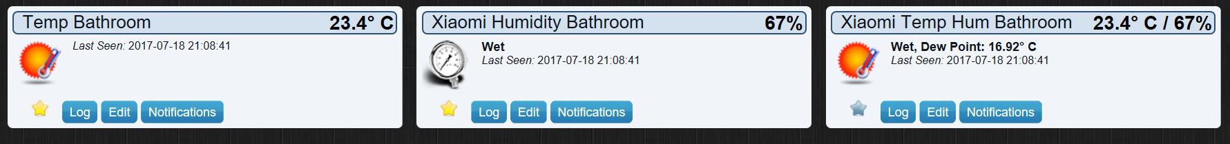

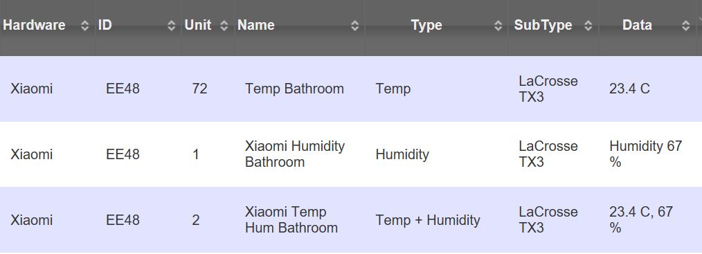

Post by booster »
I've got a Xiaomi temp + humidity sensor, and was hoping I could use the humidity value in blockly to trigger the ventilator based on its value.
however, the humidity value doesn't seem to be populated...instead I now see a value 3 for some reason.
same happens with another sensor...Is there a way to get the real humidity value in my blockly?
hope the screendumps help to understand the issue
ok on the dashboard
here it says temp+hum+3... humidity is loaded with value 3 and not 67
