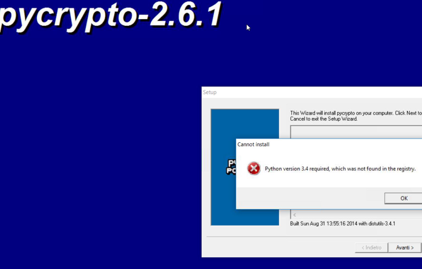

rafal wrote:
Andree wrote:i'm becoming crazy.
Install same package and configuration of Rafal and now i have same problem of your previus post!
error: Unable to find vcvarsall.bat
Cleaning up...
Command C:\Python34\python.exe -c "import setuptools, tokenize;__file__='C:\\Users\\andre\\AppData\\Local\\Temp\\pip_build_andre\\pycrypto\\setup.py';exec(compile(getattr(tokenize, 'open', open)(__file__).read().replace('\r\n', '\n'), __file__, 'exec'))" install --record C:\Users\andre\AppData\Local\Temp\pip-swj86p1y-record\install-record.txt --single-version-externally-managed --compile failed with error code 1 in C:\Users\andre\AppData\Local\Temp\pip_build_andre\pycrypto
Storing debug log for failure in C:\Users\andre\pip\pip.log
Uninstall ALL version of python, then restart windows and with admin right install python 3.4.0 then with admin right pycrypto and setup. If dosen't work try do the same configuration on different windows or machine
If install Python 3.4.0 install of Pycrypto fail with

zak45 wrote:@andree
try 3.5.3 x86 and pycrypto-2.6.1-cp35-none-win32.whl on dropbox.
had worked for me.
Same Zak...in domoticz log persist
2017-07-02 19:05:50.975 EventSystem - Python: Failed dynamic library load, install the latest libpython3.x library that is available for your platform.

Hi,i'm here!
Domoticz 3.8x - Python 3.4 setup.exe not work
Domoticz 3.8x- Python 3.5.3 setup.exe work but don't see HW in Domoticz and in Log "EventSystem - Python: Failed dynamic library load, install the latest libpython3.x library that is available for your platform."
Domoticz 3.8x - Python 3.6.1 setup.exe non work but in Domoticz "PluginSystem: Started, Python version '3.6.1'."
and now update..
Domoticz 3.8x - Python 3.5.3 and 3.6.1 installed (both with all user sure) - Setup Work , In Log " PluginSystem: Started, Python version '3.6.1'." and in HW i see HW Broadlink with Kodi Remote but if configure it no device appears and in LOG
" 2017-07-07 10:06:57.550 Error: (BroadlinkRM2) failed to load 'plugin.py', Python Path used was 'C:\Program Files (x86)\Domoticz\plugins\BroadlinkRM2\;C:\Program Files (x86)\Python36-32\python36.zip;C:\Program Files (x86)\Python36-32\Lib\;C:\Program Files (x86)\Python36-32\DLLs\;C:\Program Files (x86)\Domoticz'.
2017-07-07 10:06:57.550 Error: (Broadlink Sala) Module Import failed, exception: 'ModuleNotFoundError'
2017-07-07 10:06:57.551 Error: (Broadlink Sala) Module Import failed: ' Name: broadlink' "

@Andree
try:
open cmd as Administrator
execute : pip install broadlink
