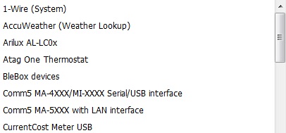

hi Zak,i've install new beta 3.8007,new package Setup.exe from dropbox,install work fine and in Domoticz\plugins\ there are Broadlink file but in Domoticz nothing happen,Broadlink HW not appears.
Can you help me please?!
zak45
- Posts: 954
- Joined: Sunday 22 January 2017 11:37
- Target OS: Windows
- Domoticz version: V2024.4
Re: Python Plugin: Broadlink RM2 V3
try to restart your Domoticz.Andree wrote:hi Zak,i've install new beta 3.8007,new package Setup.exe from dropbox,install work fine and in Domoticz\plugins\ there are Broadlink file but in Domoticz nothing happen,Broadlink HW not appears.
