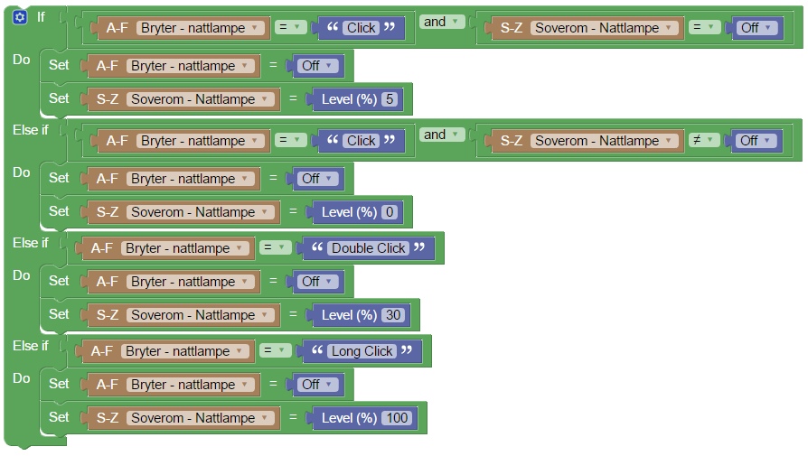

This works nicely for my wireless buttons (the round ones). Click = 5% light. Double Click is 30 % and Long Click is 100 %. One click if lamp is on = turn off. I have Off Delay set to 1 second on the switch. Bryter - nattlampe = Switch, Soverom - Nattlampe = light.
2017-06-08 18_14_43-Domoticz.png (58.82 KiB) Viewed 3346 times

quack3d wrote:This works nicely for my wireless buttons (the round ones). Click = 5% light. Double Click is 30 % and Long Click is 100 %. One click if lamp is on = turn off. I have Off Delay set to 1 second on the switch. Bryter - nattlampe = Switch, Soverom - Nattlampe = light.
Great thanks for the tipp with, now i dont need the delay :lol:
