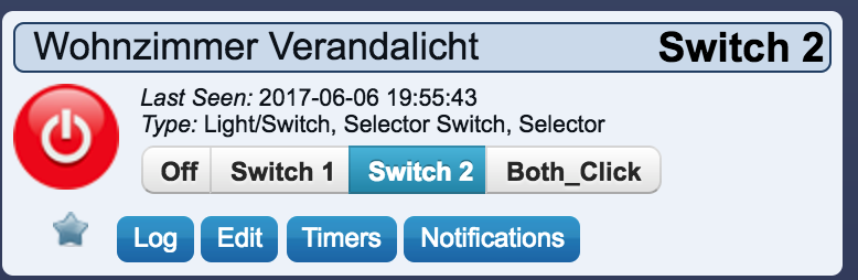

Hi i have the Dual Button Wireless Switch http://www.gearbest.com/alarm-systems/pp_610095.html in my domoticz it shows like:
however it shows not supported in homekit ;-(, need some help

I also have the single wireless wall switch http://www.gearbest.com/access-control/pp_626696.html I can switch it on but not off (both homekit and domotics Dashboard, it shows like this:
I tried Selector and on/off, however its not working :-(

Try to set an off delay in switch settings to 1 sec

Thanks, however if i do that i only can switch off ;-) and in homekit the switch goes on and 1 second later off

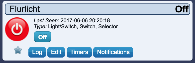

Hi there I have a aqara http://www.gearbest.com/access-control/pp_626696.htmlpush button. I am trying to configure it to use on/off. However it shows on but I can not switch it off if i press the button again, tried delay on button off button on/off button nothing is working :-(

langoo

theo69 wrote:Hi there I have a aqara http://www.gearbest.com/access-control/pp_626696.htmlpush button. I am trying to configure it to use on/off. However it shows on but I can not switch it off if i press the button again, tried delay on button off button on/off button nothing is working :-(
Is nobody using one of these wireless wall switches?
