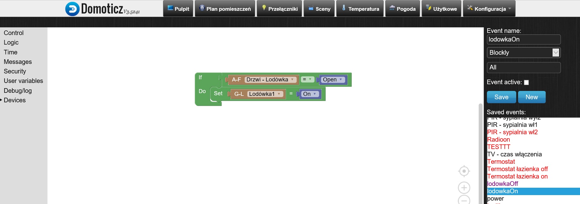

EDIT:
Thx for Dummy switch idea but I have strange problem. I made Dummy switch named (Lodówka1). My Fridge door switch is (Drzwi - Lodówka). I made two Blocky Scripts but everytime I activate them and try opem my fridge my Dummy switch do nothing. When I open my Blocky scripts page my new two script are Purple colour and deactivated (mayby someone had this problem - I see Purple colour for he first time)
Thanks Everyone for help
Best regards

Not seen purple before but a quick look on Events Wiki - "Purple = Disabled because a missing device was used [ Domoticz stops this Blockly automatic! ]"
Both devices showing in switches ok?
Once sorted you probably want to change the drop down on the right from "All" to "Device" and you could use a else if for the off statement too for the off statement.
If you want to use the time one. Create a variable under Setup > More Options > User Variables > give it a name, type = integer, Value = 0

Thx a lot for help
I changed All to Device and now everythong works!:)
I will also try Your script some time later and write if works.
