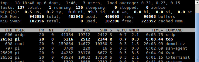

After configuring this script on my machine i'm getting log entries that the script takes more than 10 seconds to run.
also, Domoticz itself gets unresponsive and laggy...
anyone else having this problem? I'm running Domoticz on a Raspberry Pi 2B

Today i change from a windows machine to a Raspberry PI 3B.
Only had to change the location of the LUA script and the IDs of the sensors.
works for me :-)
Also i don't have any errors as you can see in my log.

Has anyone had issue of blocklys not working after this lua runs for a day or so. Only a Domo restart works.
