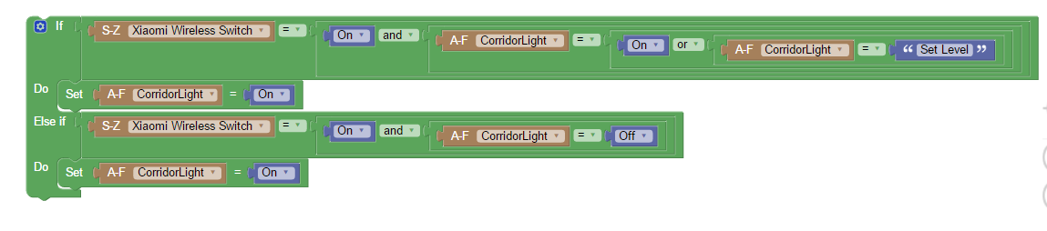

Hi, If someone can explain in short, Gateway works ok, domoticz find and show all in log, I have added switch, also recognized, now this is a little bit offtopic but can someone give me a tip how to use for example one click on switch and turn on gateway light, again one click turn off, same for double click long press etc. Trough scenes or blocky!?
BTW this is great, I use domoticz mostly for temp monitoring with esp8266 but this is very affordable solution and top of that battery powered :-). So far work nice, device conf and everthing but now is for me little hard to understand how to enable switch and assign, create interaction with other devices.

doxikus wrote:Hi, If someone can explain in short, Gateway works ok, domoticz find and show all in log, I have added switch, also recognized, now this is a little bit offtopic but can someone give me a tip how to use for example one click on switch and turn on gateway light, again one click turn off, same for double click long press etc. Trough scenes or blocky!?
Not really a blocky Fan,
it should look similiar to:
IMHO it is easier in LUA..
