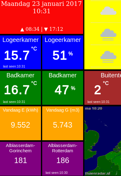

I am using the frontpage-version by Swordfish, which is based on the frontpage of this thread, just some tweaks to cell colors etc. What I cannot achieve is displaying travel times in the frontpage. When I browse the Domoticz database I can see the custom sensor (ID=181) and its value (sValue=12), but I cannot use the sValue. It just displays the Id-number. I can retrieve a few of the other fields of this custom sensor, like CustomImage.
Is there any way to retrieve and display in the Frontpage?
Inserting "Minuten"doesn't work as well:
        ['181','Minuten',               'cell8',        'Alblasserdam-Gorinchem','1','0'],
See left under, nr 181

To answer my own question... :D
I had to look up the available datafields, for example in: http://127.0.0.1:8080/json.htm?type=devices&plan=0
There it was clear that I needed the contents of "Data":
So the right line is:
['181','Data',          'cell8',        'Alblasserdam-Gorinchem','1','0'],
