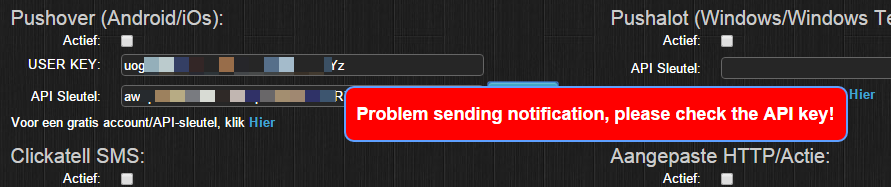

Problem with Pushover configuration
I'm having trouble with configuring Pushover with Domoticz on my Raspberry Pi2B. I registered Domoticz as an app, then I filled in my user key en API token on the settings page. But if I push the Test button, in a red box the following message is displayed: Problem sending notification, please check the api key!
Anyone any suggestion?
Pushing notification from my desktop to my Pushover android client works just fine.

May be you have a white space before or after the api key?

@jannl: thanks for your suggestion, but no, no leading or trailing spaces (I doublechecked).
See attached screenshot of the Domoticz Pushover configuration errormessage.
- Domoticz Pushover configuration error
- 20151221 domoticz pushover error.png (47.89 KiB) Viewed 10545 times

Not sure if for testing 'actief' must be checked.

I got this message also at first setup.
After saving settings and go back to testing, it worked for me.

@hjvingen: yep, that did it. Thnx!
