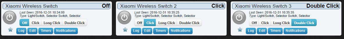

corbin wrote:
Yes these events are reported by the gateway, but I don't know what to translate them to in Domoticz. Have you a suggestion?
Using a selector switch !
Thanks, I just changed my source to add a selector switch, but I only see the button for "Off", not "1 Press | 2 Press | Long Press"
Is there something else to do to get those options?
deennoo
Posts: 784
Location: Bordeaux France
Post by deennoo »
My gateway is still not here.
My screen was an exemple for you
Hide off
1 press : selector 10%
2 press : selector 20%
Long press : selector 30%
You have to code it !

pavelbor wrote: May be split them into 3 independent buttons (switches without state)?
That would be ok, but if the switch deennoo has posted can work, it looks the goods!

deennoo wrote:Hide off
I just ticked "Hide Off level", but that doesn't work, where do i Hide Off?

corbin wrote:
deennoo wrote:My gateway is still not here.
Hide off
Oh, haha!
I'm not going to code that, but you are welcome to :)
Is this something that could be done with the new Python add on?
Will try to help when my gateway will arrive.
About coding/linking switch status to selector switch, i think first that you have to understand that selector is just a dimmer (like yeelight mono bulb) switch with predefin step.
Selector api : https://www.domoticz.com/wiki/Domoticz_ ... tor_Switch
As our switch got 3 status, we need 3 steps, 3 % values
If your able to parse switch message, it need a rules like
If recieve switch xx 1 pluse then selector = 10%
Else if If recieve switch xx 2 pluse then selector = 20%
Else if If recieve switch xx long pulse then selector = 30%
At creation instead of creating push on , select : selector and try adding rules.
Second solution :
Update a text device with switch status message on it.
And python plugin are still on beginning (need to have an installer, and finishing evaluating how it works, if we can call various lib etc etc) as this is a new feature and looks hard to develop this can take time.
http://domo-attitude.fr
corbin
Posts: 463
Location: Brisbane, Australia
Post by corbin »
I was adding the selector switch in a wrong way. Have done it through the Domoticz GUI now and see the extra options - so will be simple to hook up the code.

Switches now have the extra options:

corbin wrote:Switches now have the extra options:
to check it is need to do it?
Great ! Very great !
