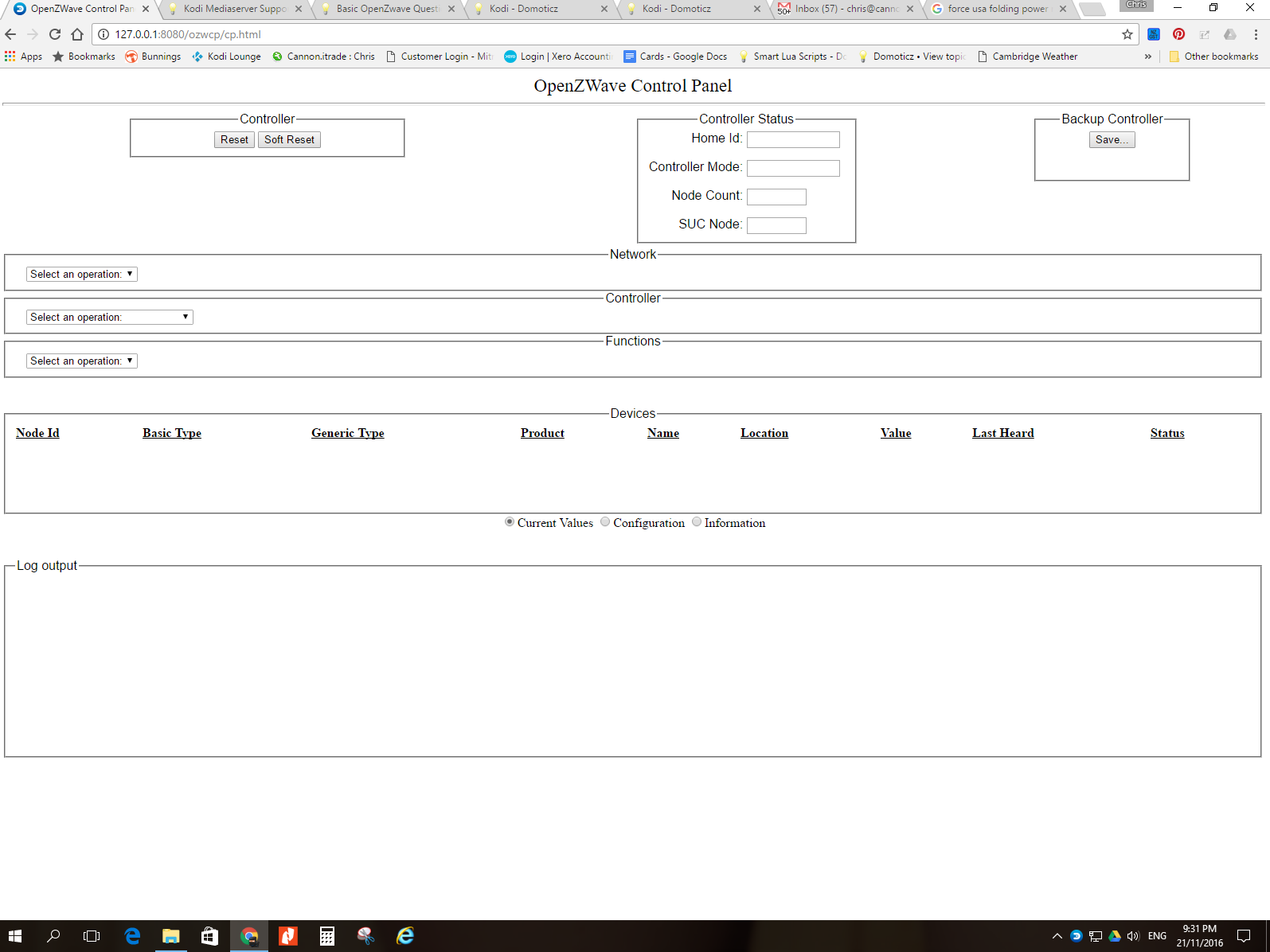

Then, once in OZWCP the screen is empty? Can you post a screenshot?

Yes I figured that bit out after awhile :) but still a blank control panel as in the screenshot

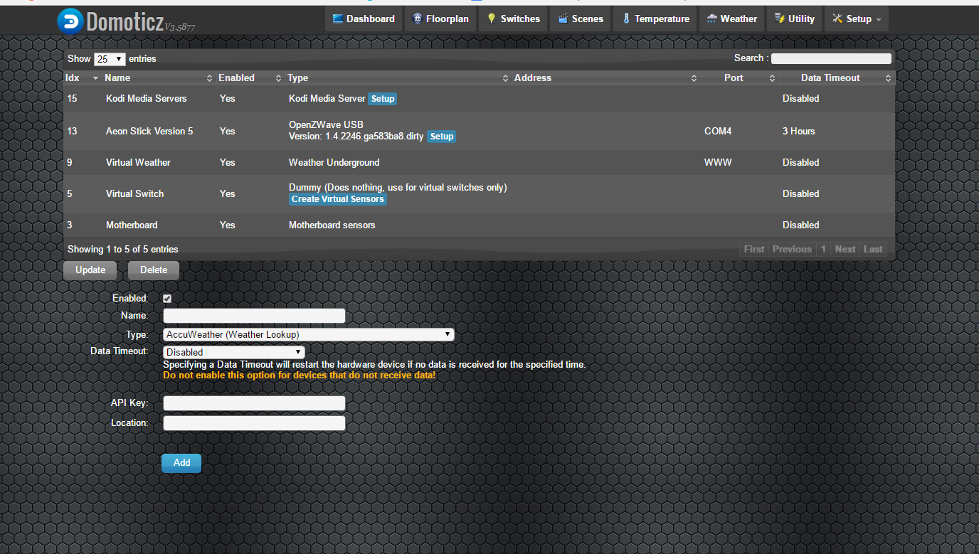

Can you post a screenshot from the domoticz hardware ??
