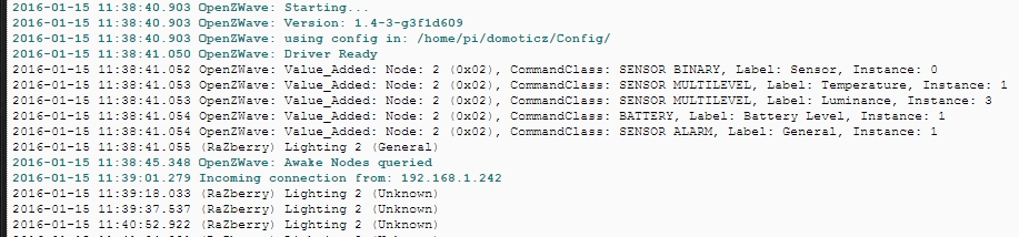

As seen on attached picture of log I am using standard Domoticz-RPI image and Open z-wave without any modification.

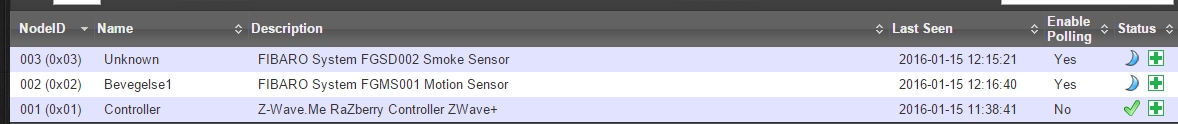

- Hardeare-z-wave

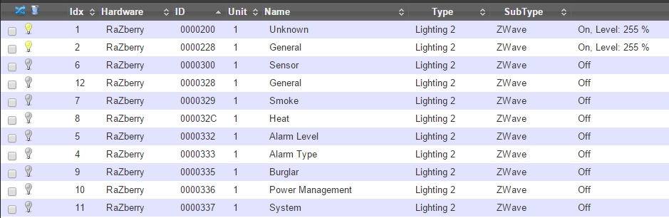

- Devices

These Fibaro devices can be very slow in sending and updating their devices without some help.
Have you triple clicked the B-button so the LED glows blue?
Many users (i.e. me) also change these nodes' configurations to make their report intervals more frequent, and report thresholds lower.

Ok, thanks for your quick reply. After posting, the Lux monitor showed up as Lux / Lux with value, but i have tried to trigger the smokealarm, but it has not changed devicetype in domoticz.
I tried z-wave.me image on my other Pi and it seemed to work in that software, but as far as i know Domoticz is a much better software solution. I have run Domoticz for several years, but only with rfxcom. I want the two way communication for my smoke sensors.
I will then wait a while and I hope the devices shows up correct (sensor=sensor and so on)
