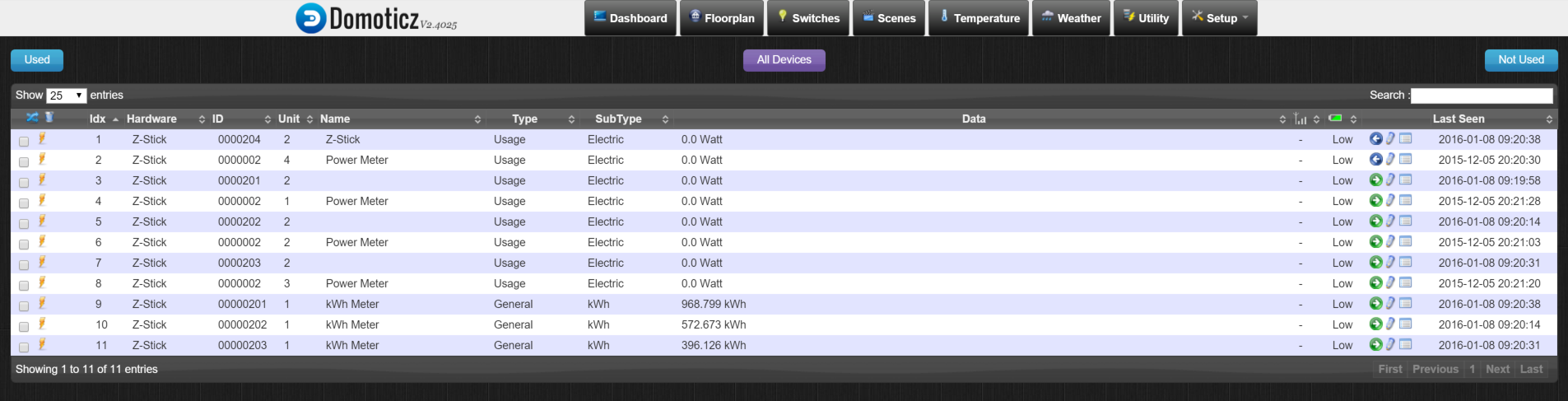

I have tried adding all of these many devices as a Domoticz device but even though some have kWh data in the Devices section, none provide any graphing information whatsoever.
Here are a few screenshots to show where things are:

Are you sure you connected the device correctly?
It is reporting zero's to Domoticz so it is not measuring anything.

In the first screenshot if you scroll to the bottom it is collecting some sort of kWh information but it generates a new device each time. I am certain that this device is properly connected to the circuit panel. My uncertainty is regarding best practice on how to show the collected data in Domoticz. Thanks for any advice.
