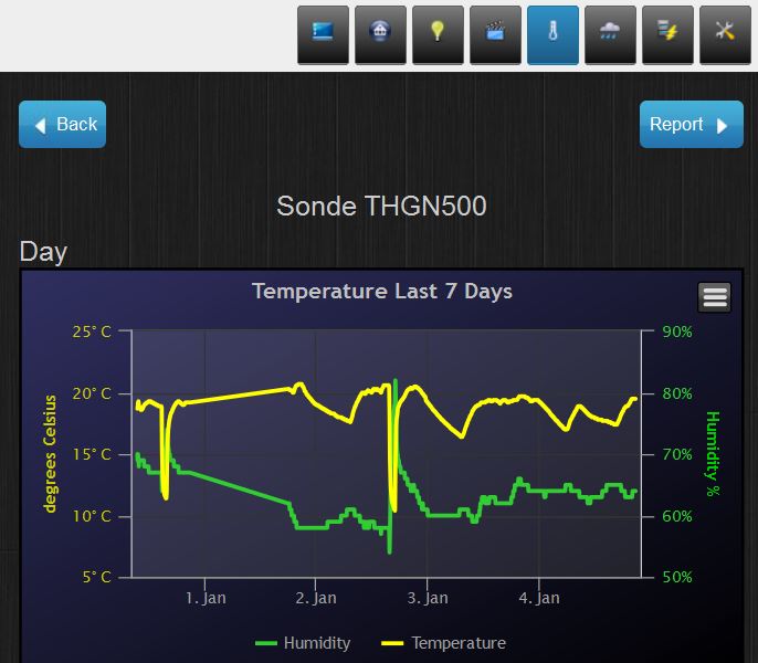

Did someone knows how to retrieve the values of the log of temperature in a "device lua script" ?
I'm looking to check on the 20 last statements if the temperature has gone under 0°C. (It's a condition to use a rolling shutter for veranda roof)
I planned to decode Json of http://127.0.0.1:8081/json.htm?type=gra ... &range=day
But I didn't succeed with this script. (as I have explaned here : viewtopic.php?f=23&t=9662)

This code work for me. It calculates the average temperature for the last 7 days.
