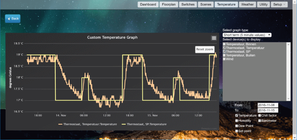

In an attempt to improve my heating control script I have a dummy Temperature sensor that gets updated with the Thermostat Setpoint (utility) to be able to plot a chart like this
would be nice to see gas consumption or boiler on-time in the same chart but they would need a second Y-axis
if domoticz could produce more options to plot combined data for analysis that would be great!
Somewhat in line with this,... When I click on a custom sensor icon on the floorplan I get a blank page, and not the log as for any other temp/weather/utility sensor.
In your case Silenus, you could update the dummy sensor with a value of say 17 when off, and 22 when on.

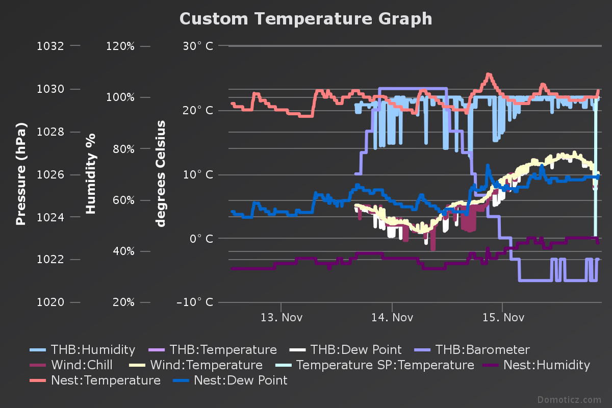

Good point, I created a small LUA script which updates the value of the dummy sensor to the Nest Setpoint value.Mike wrote:In your case Silenus, you could update the dummy sensor with a value of say 17 when off, and 22 when on.
Still, it would be useful to combine any other data in the same graph.
I've seen graphs in Domoticz where they use multiple Y-axis on the left side, but I can't recall where though.
If I found it again I'll post it.
Edit: It actually was on the Custom Graphs page for Temperatures
