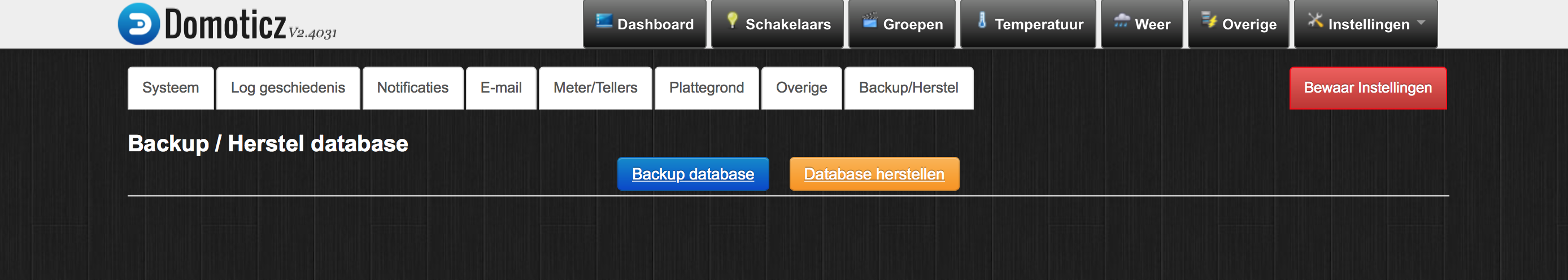

Settings / Settings / Backup and recovery.
Dutch setting on the screen cap
edit: Wow, big picture

Re: Back network on Z-Wave.me
I'm not too sure that the backup capability of Domoticz also covers the "hardware" part, considering that known nodes and network is actually data on the USB controller itself.
Please see this thread.
viewtopic.php?t=8498
What I did is to get a secondary (actually now have three) controller to replicate the network info when it changes. No matter what happens to the first, the second can take over. The more, the better, for coverage and safety.
