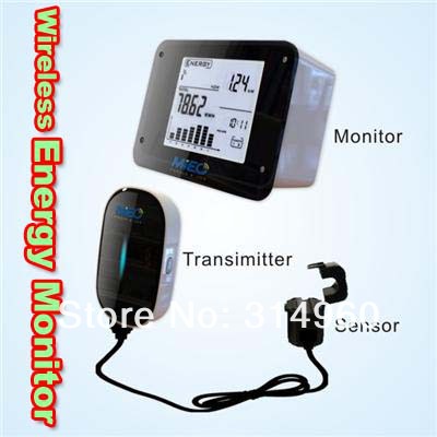

Somebody got Mieo HA102 or test this unit? Compatible with domoticz?
LINK
Look promising and have 433mhz transmitter.
Specification:
1) Accuracy: ≤5%
2) Measuring current: 100mA-70A Measuring range: 10W~17.5KW
3) Voltage setting: 100~250v AC
4) Transmitter sample rate: 2s, 8s, 64s
5) Transmission frequency: 433.92MHz
6) Carbon ration: 0.5kg CO2/KWH
7) Power supply: 3pcs AA for receiver(battery not include); 3pcs AA for transmitter (battery not include)
8) Wireless transmitting range:30m-70m insight.
9) Operating Temperature: -10oC~ 60 oC Storage Temperature: -20 oC ~75 oC

Almost. Transmiter 39,95 € + 1 CT 8,95 € = 48,9 € + shipping vs 48.43 $ (free shipping) with this good looking monitor (display unit). So if this is supported it will be better solution if U need 1 phase CT sensor.
On the diagram U can see the central unit connects to the router via wifi (and connected to PC) so maybe is the ability to take data via LAN to domoticz without the use of expensive devices rfxcom?

Hi, I own this device,but up to now I have no idea to get the signal.
My Rfxcom will not reconize the device..... :cry:
KR Frank
