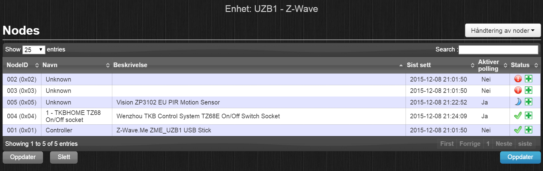

Ok, So I Added my 2. Z-Wave device to Domoticz, worked fine until I rebooted the system, now I can se the LED on the motionsensor is blinking if i am in front of it, but the "switsh" in domoticz don't turn on anymore.
How to I fix thix?
I Can see the device have a moon logo:
Uten navn.png (191.79 KiB) Viewed 2077 times
Enabled Polling (whatever that is), still don't work

Now the status-logo has changed to the normal "v", but the sensor still don't work.
Not even the LED on the sensor.
EDIT: these two is the same physical, still "last Seen" is 2h late on the sensor-part

Hi Evelen,
first of all update to newest version 2.3790. To do that you must enable beta updates (In Setup|Application settings tick "Check for Updates" and select Beta channel).
Exclude PIR and include again. Then send here a devices list (Setup>Devices).
Polling should be disabled for this device. More info here or here.
I have the same PIR too and it detects motion well. Works after restart as well.

Hi and thank you for the answer.
I have the version: 2.3596 (last beta?) Linux.
Domoticz say no (beta) update available.
Anyway, i Included the sensor "secure" yesterday, worked and then don't worked.
however it worked this morning and when i come home now.
So i guess i Just have to wait and see if it is stable.
(last seen time don't update unless it is motion though)
btw, what is the diffrence between secure and non secure node inklude??

I was having the same issue. The solution was to get a wall plug to extend the range from my razberry.
My nodes works perfectly since I bought the wall plug.
