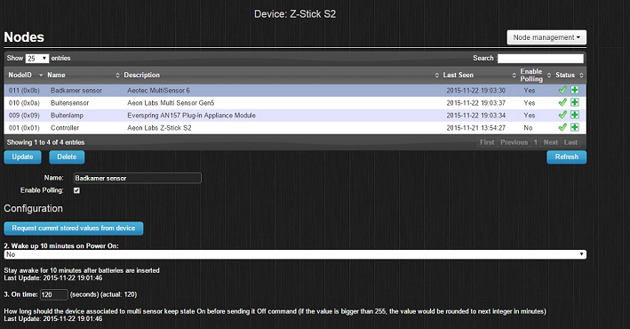

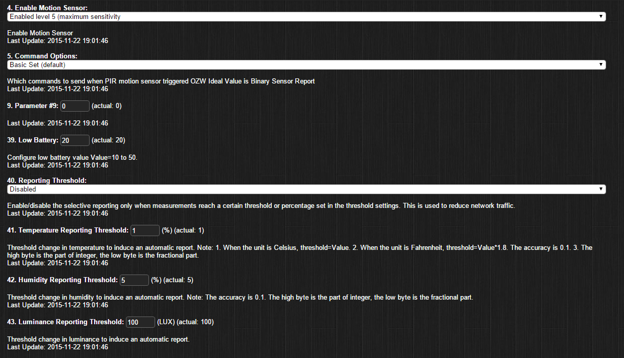

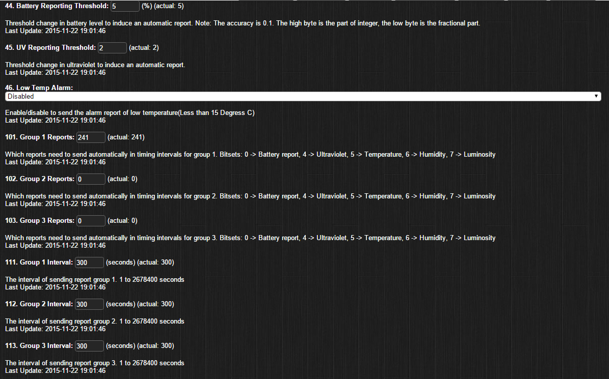

I'm using this particular sensor, USB-powered. All sensors are working fine so far, except for the calibration through Zwave. Got it working from Sept 30th without a flaw.
First of all: try the latest beta updates, that partly did the trick for me with the errors.
Second: did you include the multisensor through Domoticz of through some Z-stick device? Including through Domoticz gives ye all the parameters to change. If you included wrongly, make sure you exclude it before including again.
Third: my config:
Config 1.png (286.1 KiB) Viewed 13279 times
Config 2.png (301.88 KiB) Viewed 13279 times
Config 3.png (344.52 KiB) Viewed 13279 times

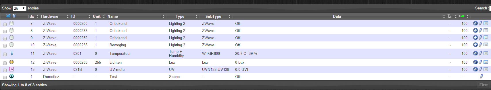

Great topic! I am having some issues with this sensor as well. Attached you see its showing 4 unknown devices. I am missing my motion sensor and vibration sensor. This is strange cause I see 4 unknown devices and only 2 sensors missing. How do I know which is which?
Thanks in advance!

@mvd87:
It's confusing, agreed. With a little help, I figured it out... I think.
When I'm looking at my own ID's, yours should be:
0000200: Motion
0000233: Alarm type
0000232: Alarm level
0000235: Burglar
Supposedly (heard this from Gizmocuz sometime ago) only temp+humidity, lux and UV are numeric sensors, giving a numeric value. You found those already (UV is working well in broad daylight, but not inside your house). The others (motion and vibration) only turn on or off. Compared with my Multisensor 5, the 0000200 must be motion. But... vibration is supposedly given by the Burglar sensor (on / off). I was disapointed by that as I hoped to be able to notice vibrations, but it doesn't work that way.
The other 2 sensors (Alarm type and Alarm level) are also to be found on the Multisensor 5. They don't do a lot for me, maybe Gizmocuz could explain. I read before that alarm type has something to do with the type of signal that triggers the multisensor in sending its signal (dunno how), and the level with the level of activation. But these 2 are very obscure for my, and I don't use 'em. You will find though, that your burglar is mostly triggered when your motion is triggered. I didn't get much extra from this one yet. But... the Lux-sensor is alot better than the one on the Multisensor 5. I think you got yourself a great sensor, and I hope it all works out the way it does for me since quite some time with both sensors.
Screenshot log.png (106.68 KiB) Viewed 13136 times
mvd87

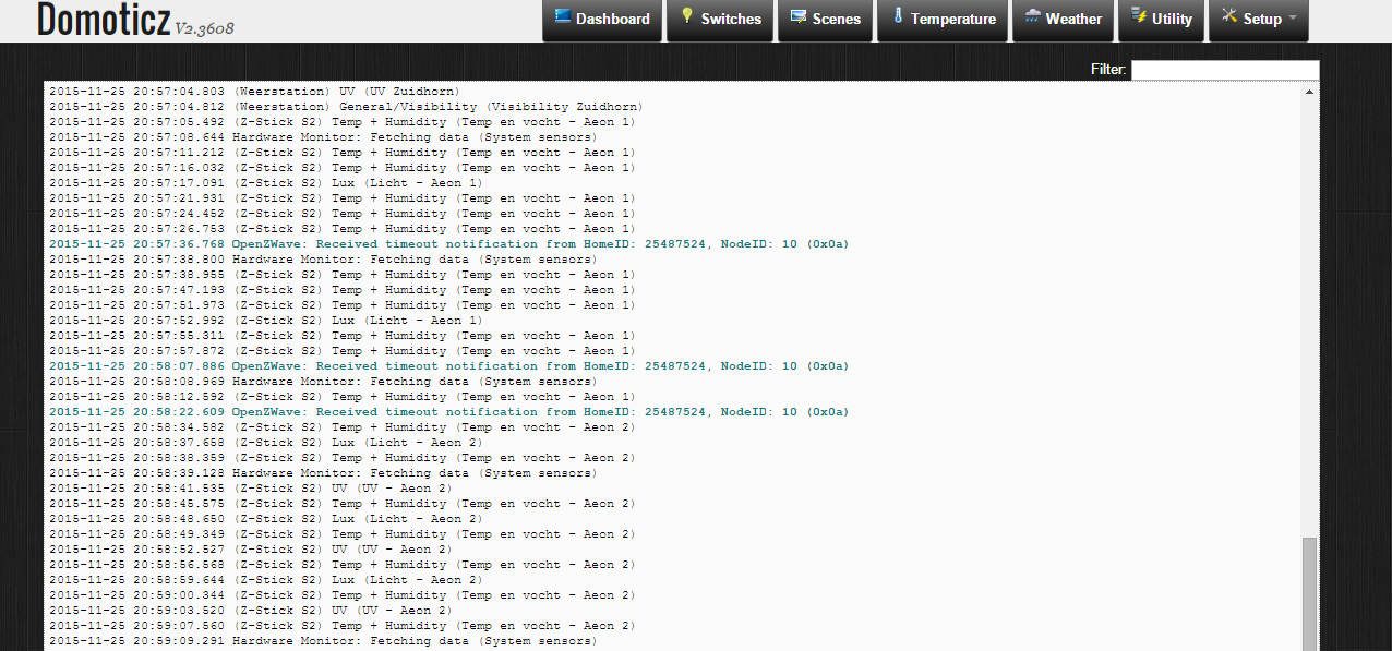

The problem I have is that one sensor reports Temp + humidity *ALL* the time while the other seems to respect the 300 seconds Group 1 report. Both have reporting thresholds disabled.
Worryingly, the one that reports all the time also has a value for Barometric Pressure (30.3 kPa) which is not good.
Has anyone else seen anything like this? I've excluded/included to no avail. Will raise a call with Aeotec if I'm the only one.
