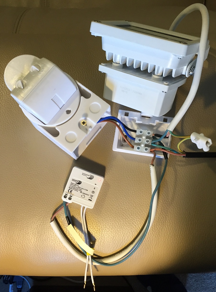

One thought I had was to use a separate floodlight and PIR and wire it (see attached) so that either the PIR or an RF relay can trigger the light (I've got a spare Home Easy HE203). This would mean that other sensors, i.e. the door sensors, could trigger the floodlight but there wouldn't be a delay from the wired PIR. However I don't think that I'll get the benefit of the wired PIR triggering other devices unless the RF relay can somehow sense that the PIR has triggered the floodlight.

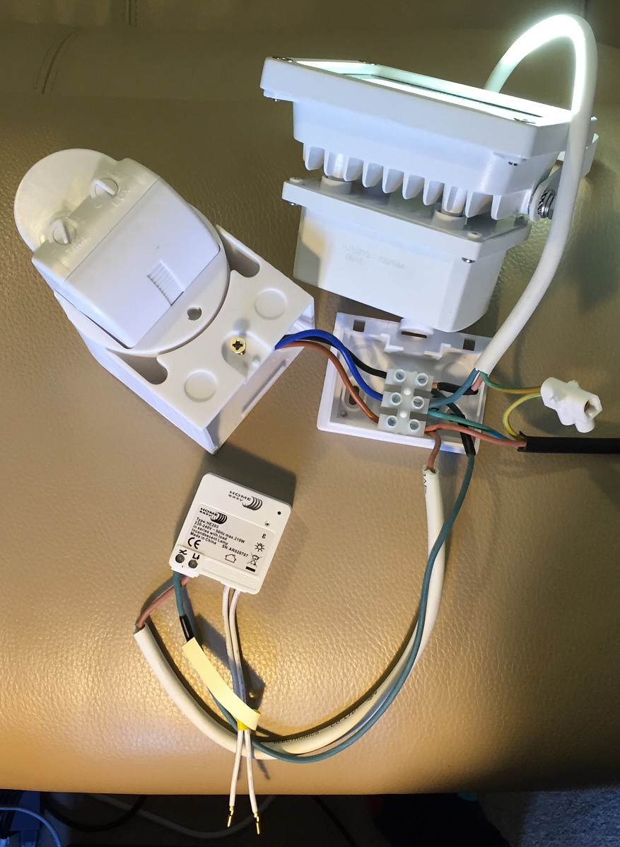

So by way of an update (hopefully to solicit replies) I've got both the PIR and Domoticz (via RFXtrx433E) triggering the floodlight. However unfortunately, as I suspected, when the PIR triggers this is not fed back into Domoticz which I would like to happen so that I can use this PIR to trigger other devices. That being said, when the PIR triggers the LED on the Home Easy HE203 goes from on to off so it must sense that the PIR has closed the circuit (see below). Any ideas? Is there another relay which would feed this back into Domoticz? Thanks.
