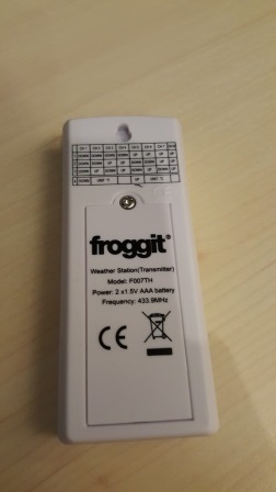

Dear Members,
I purchased some cheap Temp/Humid sensors from Amazon.de. (€9,99)
http://www.amazon.de/Transmitter-Froggi ... ds=froggit
I like these over many other sensors because of the small size, LCD screen, 8channel and IP rating.
I kind of hoped (expected?) these would work with the RFXcom TRX433E.
however, they are not detected by Domoticz.
In RFXmngr (in undec mode), I receive the following:
Packettype = UNDECODED RF Message
UNDECODED ARC:0F8440
(unit set in CH1)
How to get this device working in Domoticz?
I am not a programming type of guy :( ,so I'm also willing to donate a unit to the dev. team so they can add support for this device.
The rear of the device:
The units rear
The units rear
Anyone knows this?

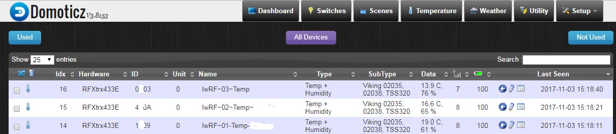

The RFXtrxE works perfect with F007TH in Domoticz v3.8153.
You must ensure the RFXtrxE use firmware Ext2. I run RFXtrx433_Ext2_1022.
See below.
