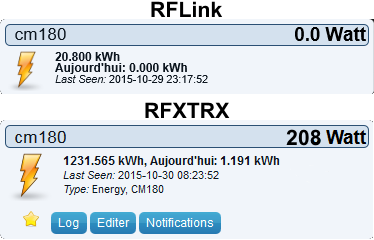

I have a problem with OWL 180, the data are received but not in the good field and the value is divided by 10

I have the same problem with Oregon UVN800
RFlink =0.0
RfXcom=2
