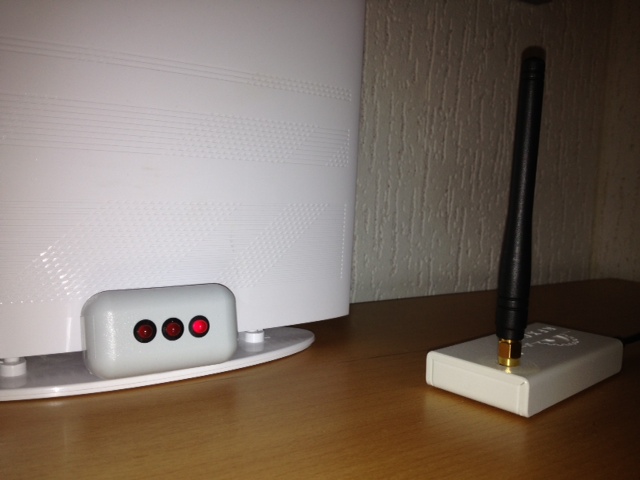

My mini-monitor! 3 LED's connected to a RaspberryPi where my Domoticz is running on.
The LED's are controlled via a script started from "domoticz_main" showing me the status from 3 important switches.
(burglar alarm active, camera active, minimum 1 door/windows is open)
[attachment=0]Foto.JPG[/attachment]

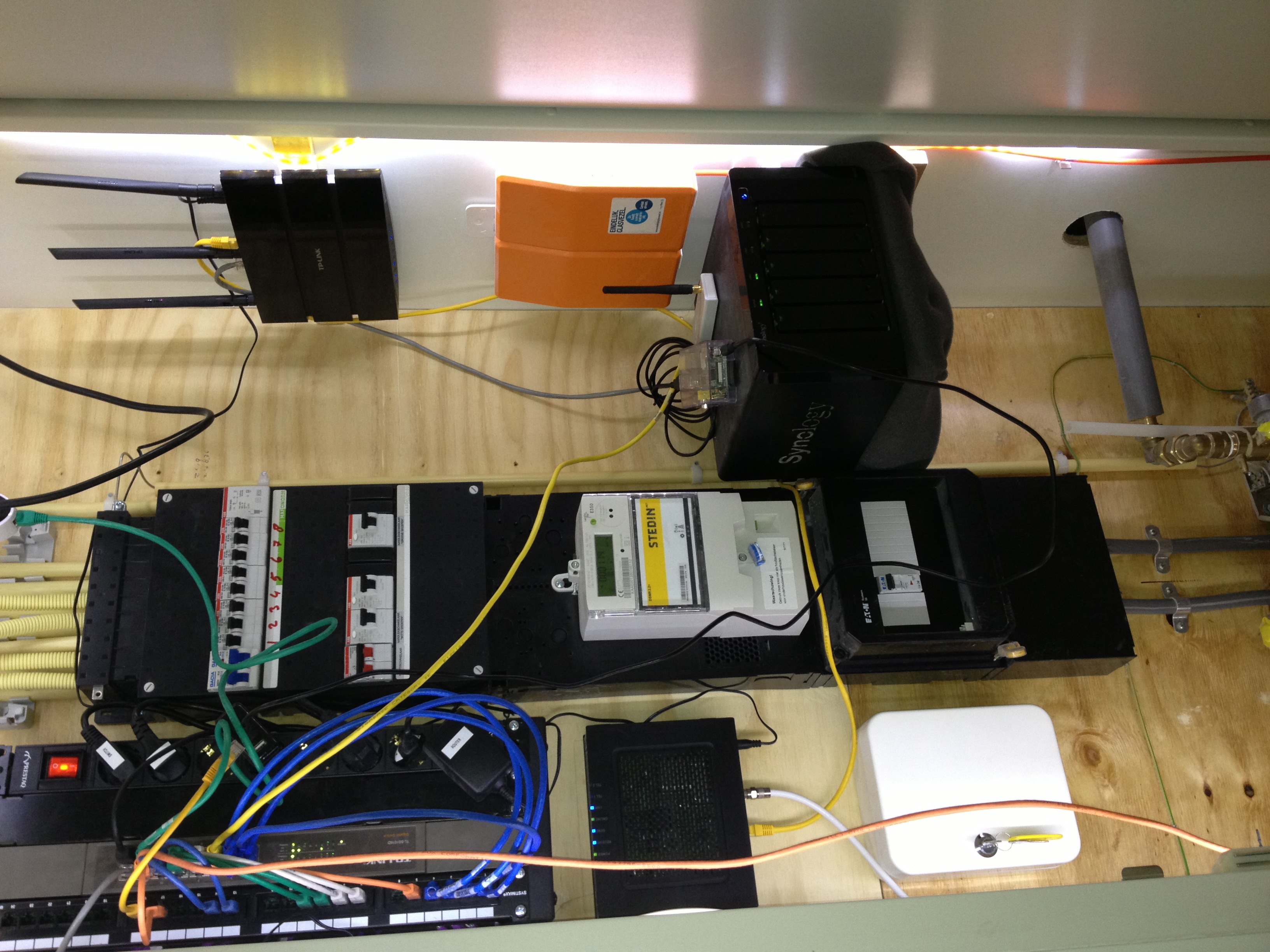

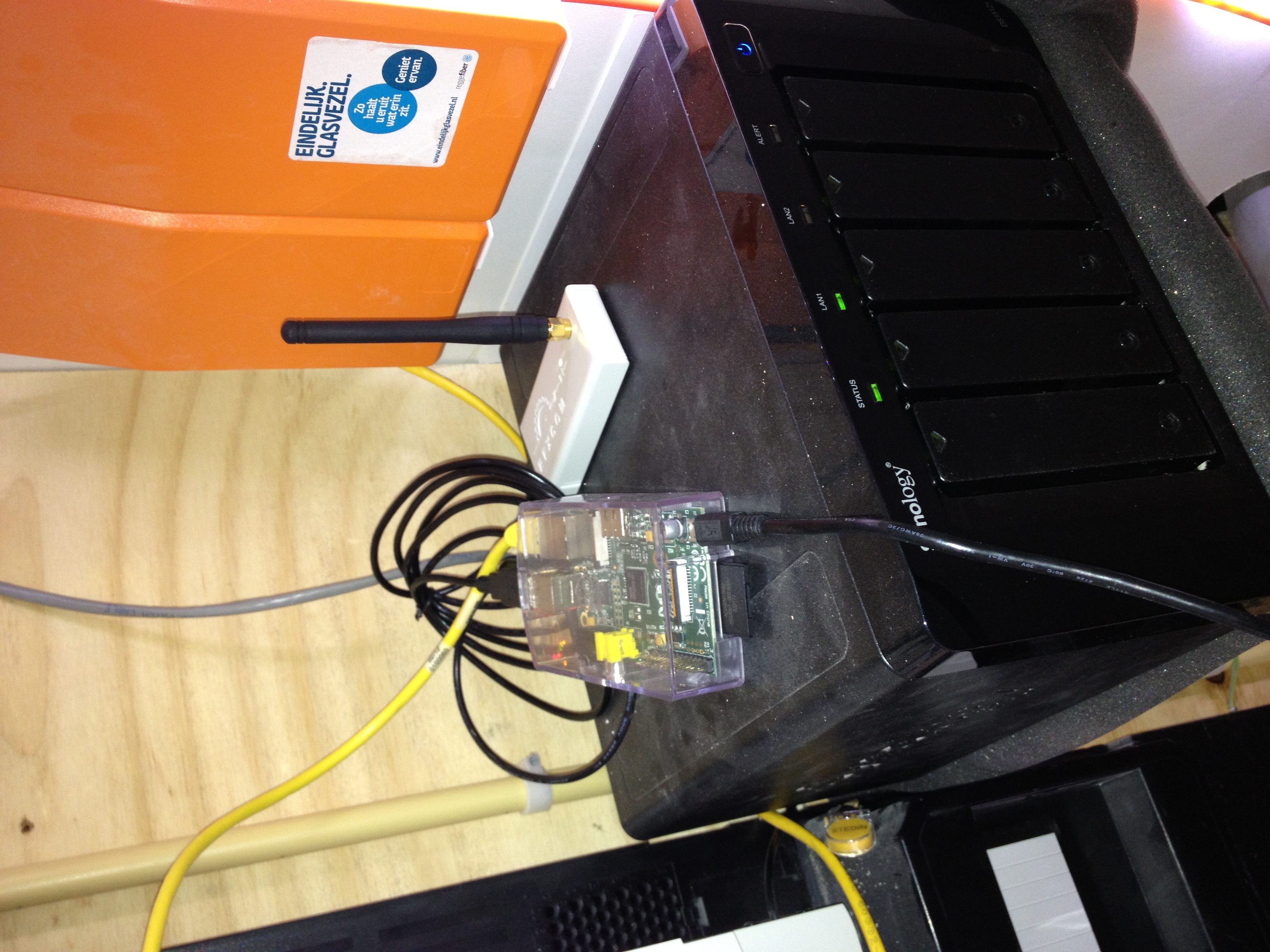

hier mijn meterkast:
raspberry 512 (voor domoticz)
Synology 1512
gigabit netwerk switch router enz.
en led lichtjes wanneer de deur opengaat :)

Damn thats a lot of storage.. I only have 2x 2 bay synologies :)

Just wondering, how did you mount the patchpanel. Is it attached to a frame??

it's a frame. bought @ netwerkproducten.com and I saw a square in the wood.

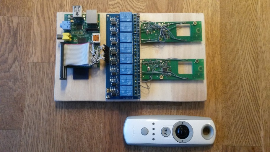

I use Domoticz to conrol various switches and my somfy blinds in two groups, so i have to use 2 remote´s from somfy over the scriptinterface and i/o board.

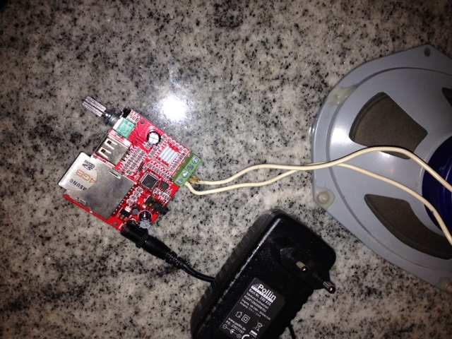

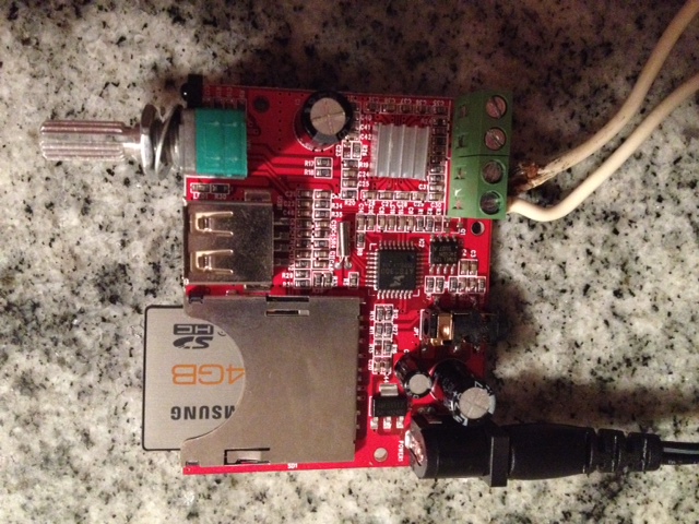

Got a new toy :D
I found this cheap sound modul: http://www.pollin.de/shop/dt/ODk1OTYzOT ... _2x10.html
To use it for additonally burglar protection I want to couple it with my doorbell via a script which checks if I've armed my alarm system. If yes it will play automatically all sound files on the SD or USB when connecting to power (12V). I placed those sounds on it:
- http://www.youtube.com/watch?v=KDnbvyrPR34 or this
- http://www.youtube.com/watch?v=NNeWxcLeu18
Additionally I need a spcecial transmitter which will be connected in parallel to my doorbell-switch. http://www.intertechno.at/produkte/send ... TS-23.html
Also a remote switch is needed which will activate the powersupply of the sound-modul.
Hardy

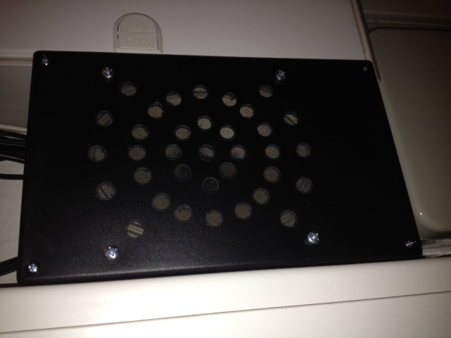

... so, finally my "barking-box" ready for operation. Will start barking when my burglar alarm system is activ and someone presses the doorbell.

Ow yes!! Cool idea. Bookmarked the toy! And in case you are home have it play a chearfull ding-dong (or Christmas song as you like). Just put 2 MP3's on the thing and select next song for the barking dog! That'll keep them away :-)
