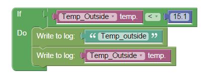

Did some test:
Temp_Ouside is a scraped value from WUnderground
Seems not to work, it does not fire the Blockly, even when temperature is changed.

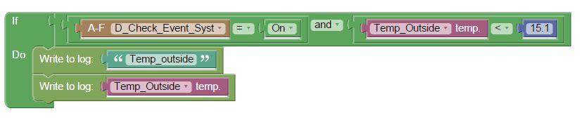

This one works, the trigger comes from the switch D_Check_Event_Syst that fires the Blockly
My ZWave DS18B20 temp sensors connected via FGBS001 do generate a trigger every time they report and as such fire the Blockly where they are used.

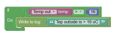

This is my simply event:
and this is log for event:
2015-09-03 22:41:47.387 Error: EventSystem: Lua script error (Blockly), Name: Test_3_1 => [string "result = 0; weekday = os.date('*t')['wday']; ..."]:1: attempt to index global 'temperaturedevice' (a nil value)
What is wrong?

I found the solution for this problem ...
You have to updateing your LUA ...
sudo apt-get install lua5.2
