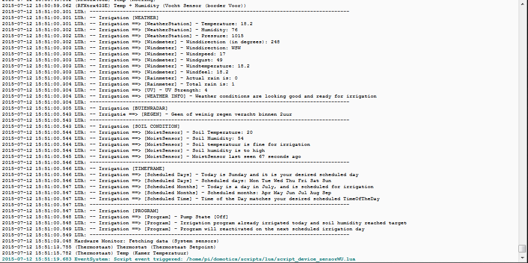

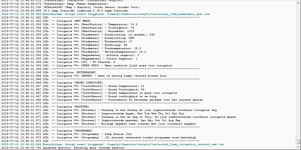

Dutch Log Translation:
English Log Translation:

-_-_-_-_-_-_-_-_-_-_-_-_-_-_-_-_-_-_-_-_-_-_-_-_-_-_-_-_-_-_-_-_-_-_-_-_-_-_-_-_-_-_-_-_-_-_-_-_-_-_-_-_-_-_-_-_-_-
This script has the intention to control and maintain your garden soil humidity.
Its a hodgepodge of different scripts found on the Domoticz forum.
Be aware that using this script for the first time it may take awhile before irrigation script has collected all the data.
I wrote this script for my own little garden project and to beable to automate irrigation while i'm gone.
The topic can be found here: https://www.domoticz.com/forum/viewtopic.php?f=38&t=6904
Somehow it got out of hand and got big.
So i thought that maybe some of you could have a benefit of this.
Although the script is intended for irrigation.
You could adapt it for other projects.
I do assume that when you want to use this script you already have the knowhow of Lua and Domoticz.
As i won't explain the entire installation ;-)
The script does the following:

          verw = 2
		  if (uservariables['VarBuienRadarCon']) == 0  then
		  commandArray['Variable:VarBuienRadarCon']= '1'
		  if logging >= 1 and logging <= 2 then
			print('-- Irrigatie ==> [REGEN] - Geen of weinig regen verwacht binnen 2uur')
-- MoistSensor Scrapping Temparature and humidity
    smoistsensorTemp, smoistsensorHumidity = otherdevices_svalues[MoistSensor]:match("([^;]+);([^;]+);([^;]+)")
    smoistsensorTemp = tonumber(smoistsensorTemp);
    smoistsensorHumidity = tonumber(smoistsensorHumidity);
		print("--------------------------------------------------------------------------------------")
	if lang == 'Dutch' then
		print("-- Irrigatie [GROND CONDITIES]");
		print("-- Irrigation [SOIL CONDITION]");
		print("-- Irrigatie ==> [VochtSensor] - Grond Temperatuur: " .. smoistsensorTemp .. " ");
		print("-- Irrigatie ==> [VochtSensor] - Grond Vochtigheid: " .. smoistsensorHumidity .. " ");

    week       = tonumber(os.date("%V"));
	month       = tostring(os.date("%b"));
    dayno       = tonumber(os.date("%d"));
    dayofweekno = tonumber(os.date("%w"));
    day       = tostring(os.date("%a"));
    hour       = tonumber(os.date("%H"));
    min       = tonumber(os.date("%M"));
-- Checking Scheduled Days
   print('-- Irrigatie [ROOSTER]')
   print('-- Irrigation [TIMEFRAME]')
if day == VarDay1 or day == VarDay2 or day == VarDay3 or day == VarDay4 or day == VarDay5 or day == VarDay6 or day == VarDay7
	then
	print(os.date("-- Irrigatie ==> [Rooster] - Vandaag is het %A en jouw ingeroosterde voorkeurs irrigatie dag"))
	print(os.date("-- Irrigation ==> [Scheduled Days] - Today is %A and it is your desired scheduled day"))
	if logging <= 2 then
	print('-- Irrigatie ==> [Rooster] - Ingeroosterde dagen: '..VarDay1..'  '..VarDay2..'  '..VarDay3..'  '..VarDay4..'  '..VarDay5..'  '..VarDay6..'  '..VarDay7..'')
	print('-- Irrigation ==> [Scheduled Days] - Scheduled days: '..VarDay1..'  '..VarDay2..'  '..VarDay3..'  '..VarDay4..'  '..VarDay5..'  '..VarDay6..'  '..VarDay7..'')
	if(uservariables['VarScheduledDays'] == 0) then
	commandArray['Variable:VarScheduledDays']= '1'
	print(os.date("-- Irrigatie ==> [Rooster] - Vandaag is het %A en is NIET jouw ingeroosterde voorkeurs irrigatie dag"))
		print(os.date("-- Irrigation ==> [Scheduled Days] - Today is %A and it is NOT your desired scheduled day"))
		print('-- Irrigation ==> [Scheduled Days] - Scheduled days are: '..VarDay1..'  '..VarDay2..'  '..VarDay3..'  '..VarDay4..'  '..VarDay5..'  '..VarDay6..'  '..VarDay7..'')
	if(uservariables['VarScheduledDays'] == 1) then
	commandArray['Variable:VarScheduledDays']= '0'
