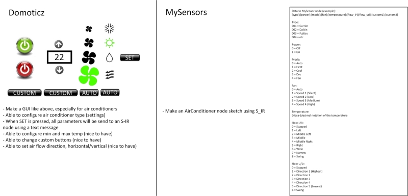

Sateetje
- Posts: 24
- Joined: Monday 07 December 2015 15:22
Re: Domoticz - air conditioning control
I'm following the project of ToniA on Github closely. He wants to control an air conditioner with Domoticz with the use of the MySensors network/nodes.
https://github.com/ToniA/arduino-heatpumpir
I want the same functionallity in Domoticz. I think more people wants to control their air conditioner from Domoticz.
Here are the threads:
viewtopic.php?f=34&t=8751
tracker.php?p=2&t=650
Please see attached file also
