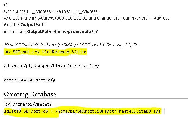

I bought and installed the Piggy Back and my rpi sees the Mac address of the piggy Back.
I am following everything at: http://www.domoticz.com/wiki/SMASpot_Mo ... n_Domoticz
When I must move the SBFspot.cfg to /bin/Release_MySQL I got an error:
mv: cannot move `SBFspot.cfg' to `bin/Release_MySQL/SBFspot.cfg': Permission denied
rights on SBFspot.cfg are on 0777, so that shouldn't be a problem.
Also creating a database like below, won't work
sql
sql
pi@raspberrypi ~/smadata $ sqlite3 SBFspot.db < /home/pi/SMAspot/SBFspot/CreateSQLiteDB.sql
-bash: sqlite3: command not found

Post by Derik »
are you pi or root?
Perhaps sudo before the command?

Post by groetg »
pi, sudo worked, thanx!
Now I am stuck at:

Post by Derik »
Login with winscp.;...
And when you make a mv or you make a document...
Click the refresh button in winscp and check or the document is there where you want.
refresh and check of the document ave the good rights...
Do this with all the steps..
