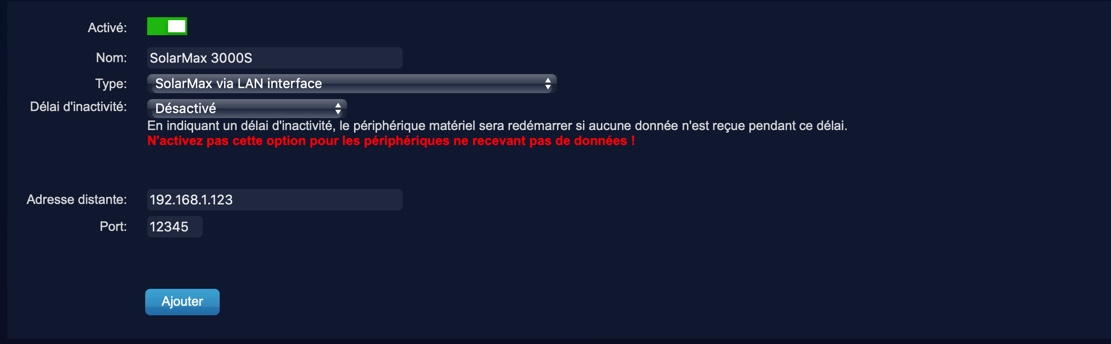

I got a Solarmax 3000S
I activate in the front panel the ethernet interface and add it to Domoticz
and nothing...
do I have to do something else?
do I have to implement something?
my Domoticz is on a raspberry Pie and update
don't I supposed to get all the drivers with?
there's 2 ethernet plug in my Solarmax 3000S and description seems to give them both as working
could U help me with this hardware please

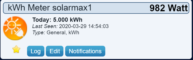

hi, before i saw the current watt and the total day kwh and total all time kwh , but after a complete new installation i dont see total of all time anymore on the dashboard or utility. the total value is visible in devices.
How can i fix this?
