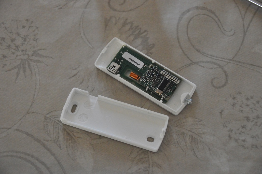

I started by looking at a module that could allow me to both receive and log the frames from my deltia unit
Looking up for 868 MHz module, most of them either :
- are fixed RF channel
- or have a variable channel but have a dedicated packet control system
- provide access to the raw output of the data slicer, BUT require a hell of a parts for the radio section (similar to what you have in a RFXcomm) and no breakout available.
Digging the datasheet of the CC1101 (TI) which is quite popular for having a ton of 433 MHz unit all over ebay, I realized that you can bypass the fifo and export the raw rx data to some of the GPIO (3 of them). However, the 868 MHz version of the module (as a chip breakout) are rare, but I finally found one on aliexpress.
The 868 MHz version is different on the RF section topology to avoid harmonics, so you can't just use a 433 MHz on which you change caps and inductors and antenna.
So I hooked that up to an arduino and started playing. I'm still waiting for my RF Explorer unit that should show up this week, so I didn't have any accurate hints about the modulation used, just found 868.3 MHz referenced in a few documents, so I tuned my CC1101 to that freq (home made helical antena)

Looking at the PCB shows that only the ASK pin is used along with the Tx enable pin, so I tapped those lines and hooked it to my logic analyzer, bingo.
(I left the tap interface in there, just in case)

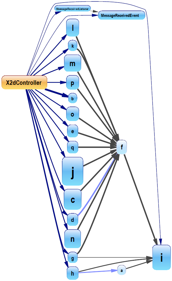

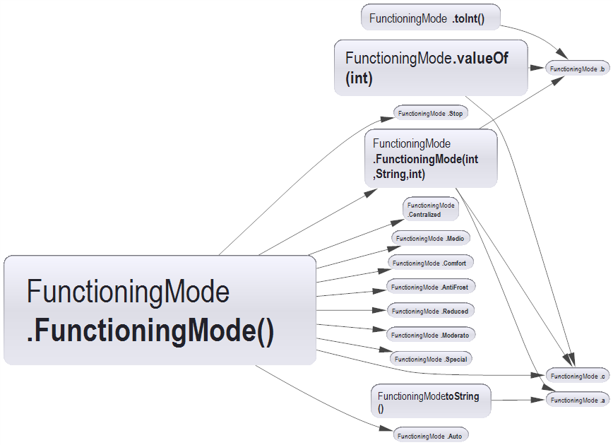

I use the USB key (emulate a port COM) with delta dore reference : Tydom360.
This key was sold by the company Myxyty (an other french company) with in reference : MyDomokit.
About this protocol, all french companies signed a special commitment to limit the sending information.
In the attach file, you can see the package with source code to use test this key. I tested it an it's work fine.

The USB X2D key has a same principe as the RS232 modem.
When I plug my USB X2D key, my computer recognize it as the COM device.
I send all message in the COM port and I receive the same type of message coming from emulate COM port.
I also attach the picture of this USB device.
Jimmy
In box device
In box device
device
device

A Callgraph to try to understand x2d library
i.class seem's to be important.
stove management part :
SixK
SixK
