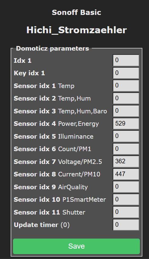

For Tasmota devices I use the "configure domoticz" section of the web interface. There I type in the IDX of the virtual domoticz devices. See screenshot (but the caption is not corresponding to the values here because it is not a switch device. It is about power in Watt and meter counts of import and export in kWh
