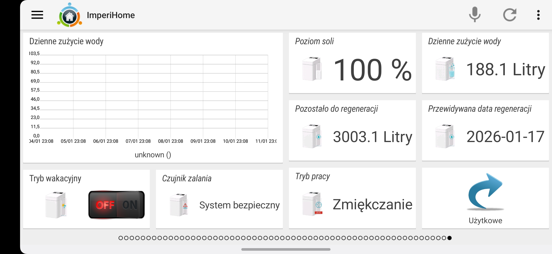

Hello, thank you very much for your suggestions - I underestimated the AI tools. Got it sorted. Everything works beautifully.

Of course, I will describe everything - I just need a moment, only late yesterday evening I managed to run a satisfactory script

Below I'm posting a script for reading data via the Aquastilla API.
It collects data such as:
- salt level
- water used today
- remaining water until the next regeneration
- expected regeneration date
- flood alarm (I have a dedicated wireless sensor connected)
- vacation mode (status preview and remote on/off capability)
- display of the current operating mode
In the future, I'll probably want to add the ability to remotely turn off the water flow – this option is available in the app.
crontab task:
The script runs once every 15 minutes. I haven't tried running it at a shorter interval, because, according to the information I have, too frequent calls can temporarily lock the account. Secondly, I don't think it makes sense to update such data too frequently.
you need to create a file and paste the following script into it (You'll need to provide your login details, IP address, and optionally, the names of the displayed information—e.g., modes or error messages)
/home/pi/domoticz/scripts/python/aquastilla_domoticz.py
The attached photo shows what types of virtual sensors should be added in domoticz.
This is my first post, so please be understanding when it comes to descriptions and information
Thanks again to waltervl for effectively pointing me in the right direction
