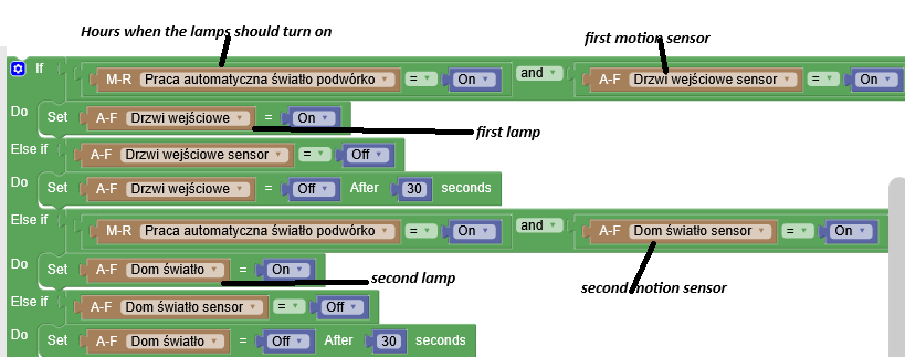

I have two lamps that I want to turn on with a motion sensor at specific times. I created a Blockly script as shown below. It turns the lamp on when the sensor detects motion, and turns it off after a set period of time after the motion sensor switches to off. It usually works well, but occasionally it won't turn off the lamp 30 seconds after the motion sensor switches to off, leaving it on continuously until I turn it off in Domoticz. Could someone explain why this is happening and help me improve the script?

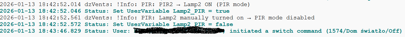

2026-01-06 22:51:24.270 dzVents: !Info: PIR2 : Script triggered by device: Dom światło sensor (ID: 1575)
2026-01-06 22:51:25.249 dzVents: !Info: PIR2 : Script triggered by device: Drzwi wejściowe sensor (ID: 69)

Maciek90

I tried the variable script, and it doesn't work correctly. When the PIR detects motion and turns on the lamp, Domoticz thinks the lamp was manually turned on and leaves it on continuously. This can be seen in the log screenshot.

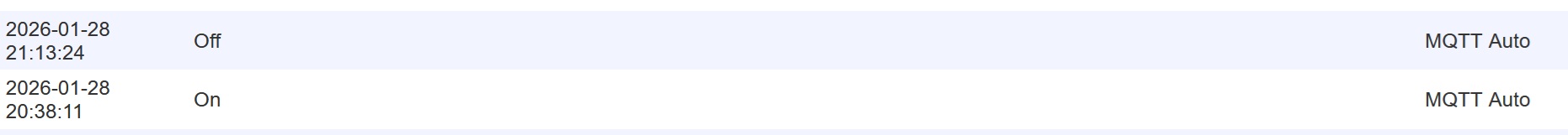

Unfortunately, the script doesn't work perfectly. There's a similar problem to the Blockly script presented in the first post: sometimes, the script won't turn off the light even though 30 seconds have passed since the motion sensor signal went off. This happens very rarely, once every few days. Below are screenshots of the Domoticz logs and the light button logs. You can see that the light turned on at 8:38 PM, and at 9:13 PM, I manually turned it off because it didn't automatically turn off after 30 seconds. There's also another problem with this script. If the light doesn't turn off after 30 seconds, the value of the variable doesn't change from 1 to 0. Therefore, when I manually turn off the light, I also have to manually change the value of the variable to 0. Otherwise, the motion sensor signal doesn't turn on the light.
2026-01-28 20:30:58.924 Status: Set UserVariable Lamp2_PIR = 1
2026-01-28 20:31:07.483 Status: Set UserVariable Lamp2_PIR = 0
2026-01-28 20:35:11.881 Status: Set UserVariable Lamp1_PIR = 1
2026-01-28 20:35:20.750 Status: Set UserVariable Lamp1_PIR = 0
2026-01-28 20:38:11.479 Status: Set UserVariable Lamp2_PIR = 1
2026-01-28 20:45:48.930 Status: Set UserVariable Lamp1_PIR = 1
2026-01-28 20:45:57.460 Status: Set UserVariable Lamp1_PIR = 0
