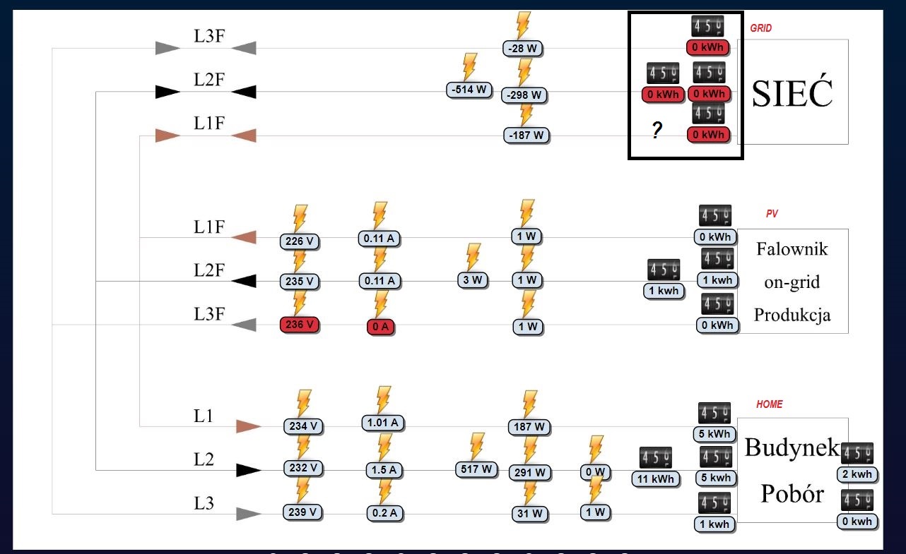

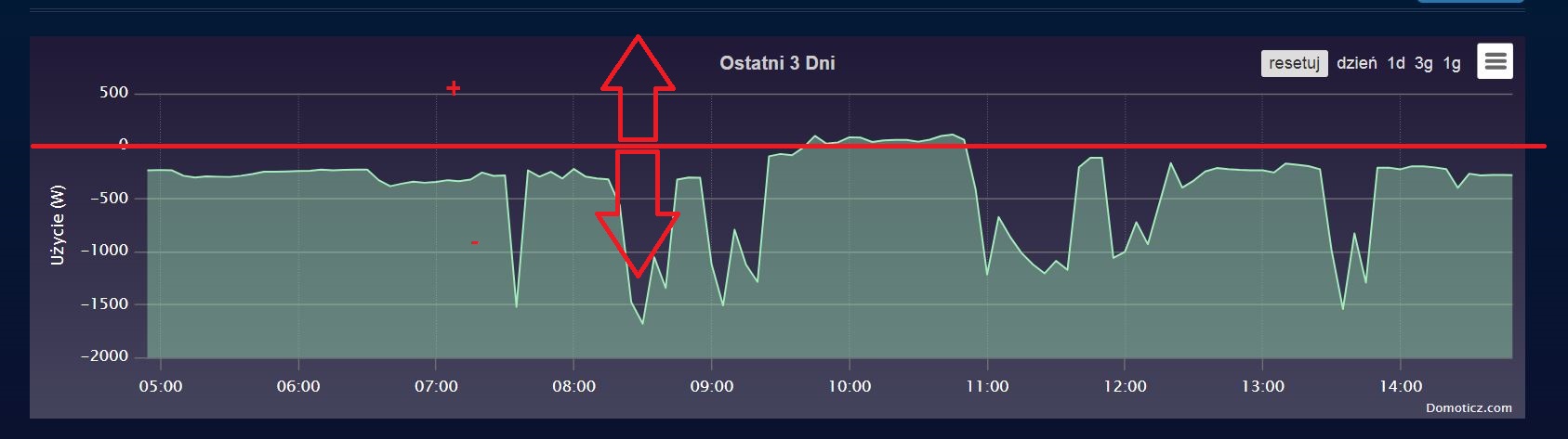

I've created my own dashboard for electricity consumption and production in a single-family home. It's based on a PZEM-004T system with six units. Three are for production and three are for consumption by the building. Now I need to create devices: the amount of energy in kWh, the energy pumped into the grid (when there's overproduction), and the energy drawn from the grid so I can compare it with the utility's bidirectional energy meter. There's a device in Domoticz called a smart meter (an attachment), but I don't know how to use it. Please help.

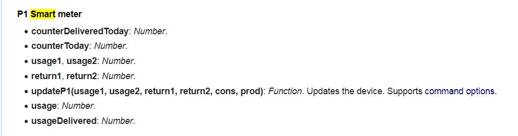

You can do that with the P1 smart meter device, it has 2 counters, one for usage and one for delivery.

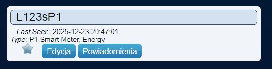

There is some problem.
Logs:
2025-12-23 20:39:31.087 Error: GetJSonDevices: exception occurred : 'stoull'
2025-12-23 20:40:00.970 Error: UpdateMultiMeter: Error converting sValue values! (IDX: 287, sValue: '-601;nil;nil;nil;nil;nil', dType: 250, sType: 1)
2025-12-23 20:43:33.064 Error: dzVents: An error occurred when calling event handler L123sP1 287 dzvents
2025-12-23 20:43:33.064 Error: dzVents: ...cripts/dzVents/generated_scripts/L123sP1 287 dzvents.lua:8: attempt to call a table value
dz vents:
Logs:
dz vents:
devices = {
160
domoticz.devices(287).updateP1(domoticz.utils.round((domoticz.devices(161).actualWatt - domoticz.devices(160).actualWatt), 0))

A P1 device needs 6 values, read the docs. You only supply 2.
