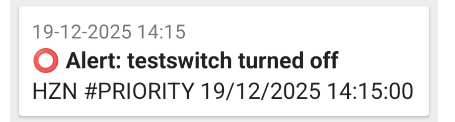

Description: a priority in the SendNotification string is not reflected in the #PRIORITY field of the customHTTP/Action settings.
commandArray[#commandArray+1] = {['SendNotification'] = '#Alert: testswitch turned off#4###http'}
I use a script to pick up the fields and send them to my ntfy-server, like this:
script://.../ntfy.sh --user #FIELD2 --topic #FIELD1 --server #TO --org "#FIELD4 #PRIORITY" --message "#MESSAGE" --prio 3
The priority is combined with #FIELD4. The expected result is "HZN 4", however this is the result:
Screenshot from 2025-12-19 14-53-46.png (24.63 KiB) Viewed 118 times
AFAIK the messge for SendNotification is build up as follows:
subject#message#priority#sound#extradata#subsystem
In case I'm wrong, let me know how to do it.

Hi and thanks for the reply. I kept the subject empty. Even when I define a notification on a switch
  • you can't set a subject, but you can set a message
  • the result is exactly the same: #PRIORITY in the report as above, instead of the selected priority. (in my case: Emergency)
--Edgar

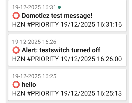

ok, i've added a subject to my notification:
commandArray[#commandArray+1] = {['SendNotification'] = 'MySubject#Alert: testswitch turned off#4###http'}
Unfortunately, there's no difference. And even when I send a test message from the customHTTP/action (test button), I don't see any priority.
The 'Hello' message is the result of turning the switch on. The Alert message is from the commandArray-call above (subject added). The test message is from the test button.
Screenshot from 2025-12-19 16-32-43.png (69.59 KiB) Viewed 92 times

edgarhildering
Posts: 38
Joined: Thursday 11 June 2015 22:36
Domoticz version: 2023.2
Re: #PRIORITY not set in settings>Notifications>CustomHTTP/Action
Post by edgarhildering »
It is not about using the priority in ntfy. That works fine. See my script where I use --prio 3. It is about getting the priority from Domoticz...

The initial problem (passing the priority) hasn't worked yet. Here's an update.
waltervl wrote: Saturday 20 December 2025 0:07 My test proofed the http notification changes #PRIORITY into a number and uses that in the http command. So it also should work for you.
  • It turns out the priority is indeed passed correctly when an http(s) call is used. I haven't been able to do this for a script call (script://).
  • After some searching, I found a way to access the message server without using a script. It works like this:
https://<message-server-address>/<topic>/publish?<key=value>&<key=value>...
  • Unfortunately, the priorities of Domoticz and NTFY are not compatible; see the table below.
domoticz prio | Domoticz code | NTFY equivalent |
   very low   |   -2          |   1             |
   low        |   -1          |   2             |
   normal     |    0          |   3             |
   high       |    1          |   4             |
   emergency  |    2          |   5             |
So, you can't use the domoticz code without some tricks. The NTFY server returns an error if the key 'priority=' is provided with an illegal value.
I'm still investigating how to use NGINX to change the value of the domoticz parameter (provided as domprio=...) to its NTFY equivalent and then add it to the URL. But at least I can get some messages now!
You are right, the notify by script section in the source does not have a #PRIORITY translation like the http part has. So you could make a GitHub issue to get this corrected.
https://github.com/domoticz/domoticz/bl ... onHTTP.cpp
