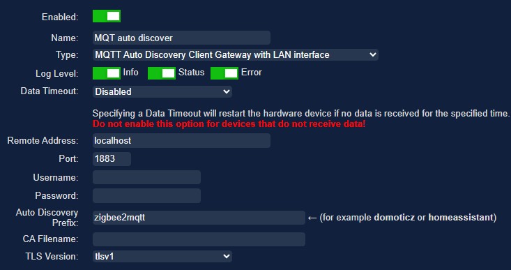

OK, i'v disabled the "MQTT2zigbee plugin" and added hardware "MQTT Autodiscover".
The zigbee-devices are shown in "zigbee2mqtt WindFrom (frontend)" and I can see information of the wallsocket (power, current and voltage). I can even swith on and off in WindForm".
The can even receive that information from MQTT by listing with""mosquitto_sub -d -t "zigbee2mqtt/#" :
.Client (null) received PUBLISH (d0, q0, r0, m0, 'zigbee2mqtt/bridge/logging', ... (226 bytes))
{"level":"info","message":"z2m:mqtt: MQTT publish: topic 'zigbee2mqtt/0x70b3d52b6014bf15', payload '{\"current\":0,\"energy\":0,\"linkquality\":55,\"power\":0,\"power_outage_memory\":\"on\",\"state\":\"ON\",\"voltage\":227}'"}
In domoticz/settings: receive new devices is on"!
But, unfortunately, nothing happens in domotics.
What am i doing wrong....?

The discovery topic normally is "homeassistant". So check the settings of zigbee2mqtt if you changed that...
And better not have the config and state topics combined in the same topic, so keep it "homeassistant"

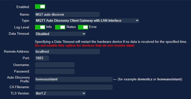

Ok, I changed the topic to homeassistant at the frontend end in the Domoticz "MQTT autodiscover" hardware.
I see with "mosquitto_sub -d -t "zhomeassistant/#" next information coming from the wall-socket when I switch it on (button om the wall-socket).
Client (null) received PUBLISH (d0, q0, r0, m0, 'homeassistant/bridge/logging', ... (229 bytes))
{"level":"info","message":"z2m:mqtt: MQTT publish: topic 'homeassistant/0x70b3d52b6014bf15', payload '{\"current\":0,\"energy\":0,\"linkquality\":70,\"power\":0,\"power_outage_memory\":\"on\",\"state\":\"OFF\",\"voltage\":225}'"}
Client (null) received PUBLISH (d0, q0, r0, m0, 'homeassistant/0x70b3d52b6014bf15', ... (106 bytes))
{"current":0,"energy":0,"linkquality":70,"power":0,"power_outage_memory":"on","state":"OFF","voltage":225}
This means that the frontend send a "home-assistant" topic message. But unfortunately stil noting is happening in Domoticz.
Even rejoining the wall-socket in the frontend-webpage, does not have any result in domoticz....
What am I doing wrong...?

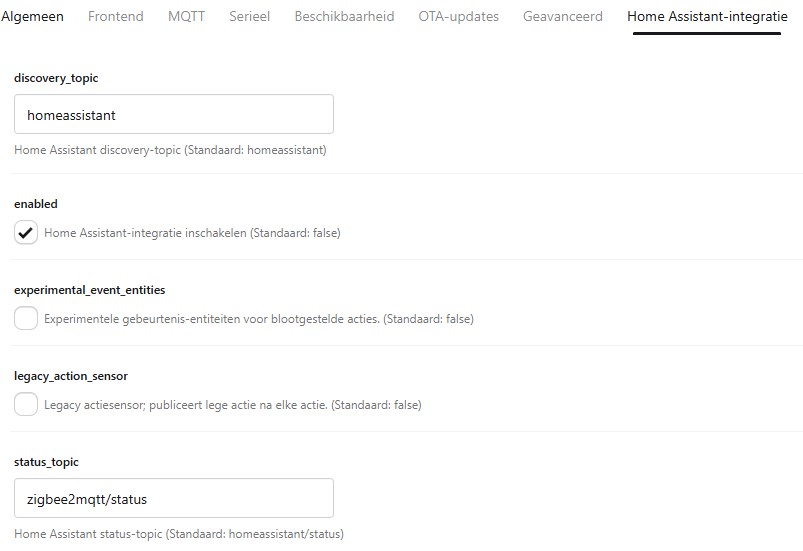

The frontend (or better backend) of Zigbee2mqtt should send config Discovery topics to "homeassistant" and the state topics with the sensor/switch values to the base topic "zigbee2mqtt"".
Check the wiki https://wiki.domoticz.com/Zigbee2MQTT#I ... igbee2MQTT

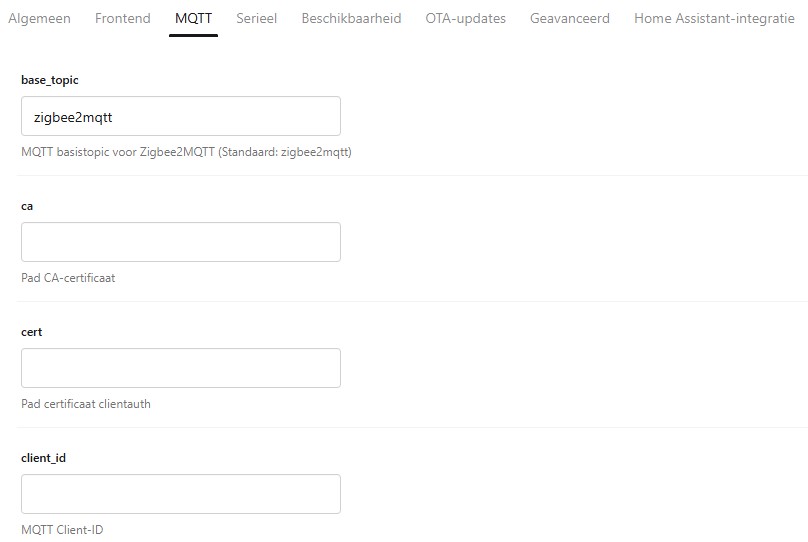

First, the status_topic is by default homeassistant/status
In the MQTT settings, make sure the base_topic is zigbee2mqtt
keep everything default nothing is checked here
shutdown zigbee2mqtt
shutdown domoticz
Use MQTT Explorer, and delete remaining nodes (homeassistant/status/base topic)... delete all?
start zigbee2mqtt
make sure it is running correct
next start domoticz
Switches you should see immediately, other sensors (like temp/hum/voltage/kwh/....) only when a update is received
