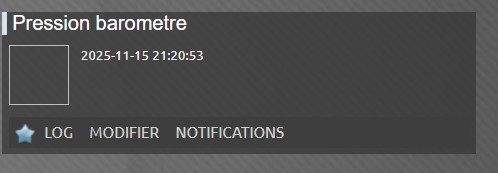

hi,
I created a dummy devic to manage the barometer pressure supplied by visual crossing.
why a got this? however the pressure appears in the device but not in the widget nor the icon.
update dummy device Baromater
- widgetBaro.jpg (15.02 KiB) Viewed 59 times

Re: update dummy device Baromater
the nvalue and svalue are coming from a script.
the device 1306 is a THB of viSual crossing wihich supply Temp, Hygrometry and Barometer.
the pressure is extracted correctly by the script but the display of the widget is not completed.
json = (loadfile "/home/kan/domoticz/scripts/lua/JSON.lua")() -- For Linux
local config=assert(io.popen("curl -s 'http://127.0.0.1:8080/json.htm?type=command¶m=getdevices&rid=1306'"))
local blocjson = config:read('*all')
config:close()
local jsonValeur = json:decode(blocjson)
Baro = jsonValeur.result[1].Barometer
commandArray ['UpdateDevice']= '1511|0|'..Baro
return commandArray

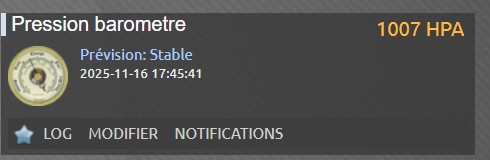

This is what is expected for nValue & sValue: https://wiki.domoticz.com/Domoticz_API/ ... #Barometer
So maybe it helps when you change the sValue to: BAR;BAR_FOR
Just as a test you could fix the forcast to 0=stable:
commandArray ['UpdateDevice']= '1511|0|'..Baro..";0"
Excellent the right syntax that works for me is what you propose but with simple strokes
i had seen the svalue needs 2 values like you say but i ignored the right syntax
Many thanks
for our pleasure
commandArray ['UpdateDevice']= '1511|0|'..Baro..';0'Many thanks
