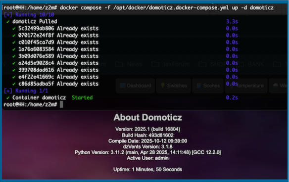

Stable tag is updated, as is the 2025.2 tag (but could be showing 2025.1 as a misconfiguration, check the compile date 2025-10-13)
Re: Version 2025.2 version number in Docker
- qqqqq.png (220.66 KiB) Viewed 318 times

What tag is in your docker compose yaml?MYXOMOP wrote: Friday 17 October 2025 17:22 2 minutes ago
https://hub.docker.com/r/domoticz/domoticz/tags
image: domoticz/domoticz:stable
- Posts: 6677
- Domoticz version: 2025.1
indeed incorrect, also for tag 2025.2.
Tecnically 2025.1 build 160804 is the same as 2025.2 but is shows incorrect.

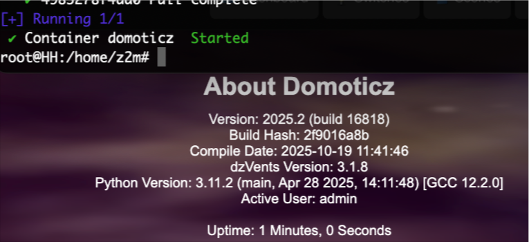

Sorry about this, it's been corrected
that's good
- qqq.png (279.13 KiB) Viewed 212 times

altough this is not the official 2025.2 version anymore being revision 2025.2.16818....should be considered Beta? The official version was 16812, based on what is written on the download page.
Also, i used the 2025.2 on the release date using the stable tag...and my revision is 16804 as indicated above....
