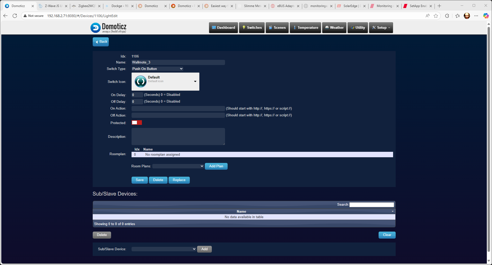

But the wallmote is a switch with multiple button correct? You can not control these with Domoticz, you can only receive the presses
In Domoticz, on the switches, press edit, and set the types to 'Push On', but you should not control them with Domoticz

I tried with only one expression behind the command, and it still gave the error. I use wallmote exactly as you described, the switch is set to "Push on button" as you said.
