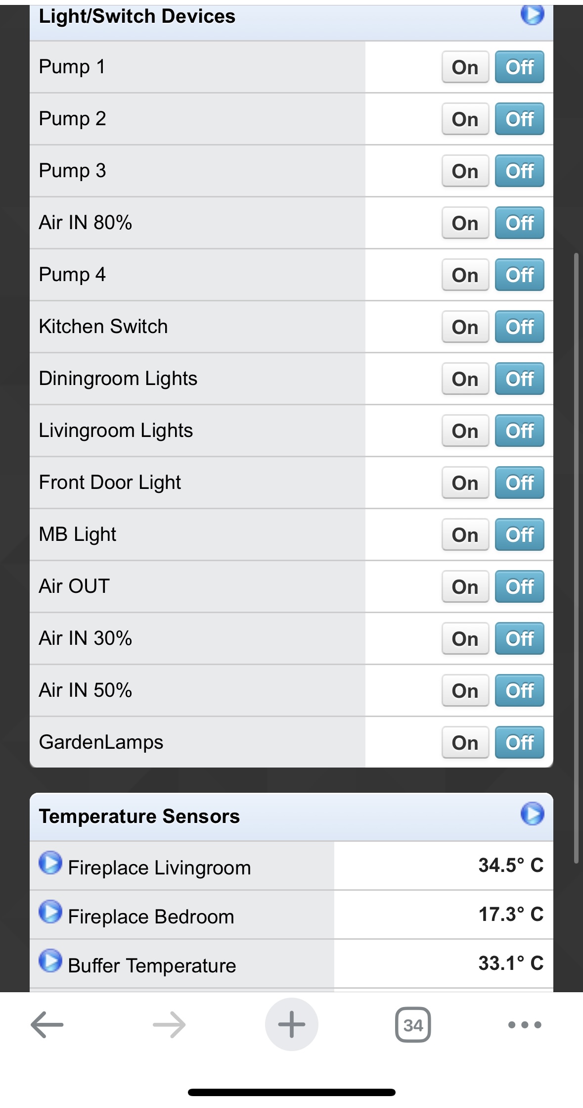

I do have way too many devices (mostly wifi switches) ,where in some cases some automations are critical for my house (as drainage pumps, ventilation ,etc.).
What Ive meant with no device is working is,that domoticz doesnt connect to any of them.
Here is a screenshot on my dashboard just as a reference:
gizmocuz
Posts: 2711
Location: Top of the world
Re: Problems after crashed SD card
Post by gizmocuz »
Most times when a SD card is crashed you can still recover some data from it.
If you go to Domoticz->Setup->Hardware, what hardware have you enabled here?
What hardware do you use to connect to your wifi switches? Could it by it is all done via a Python plugin? And is this plugin installed?
