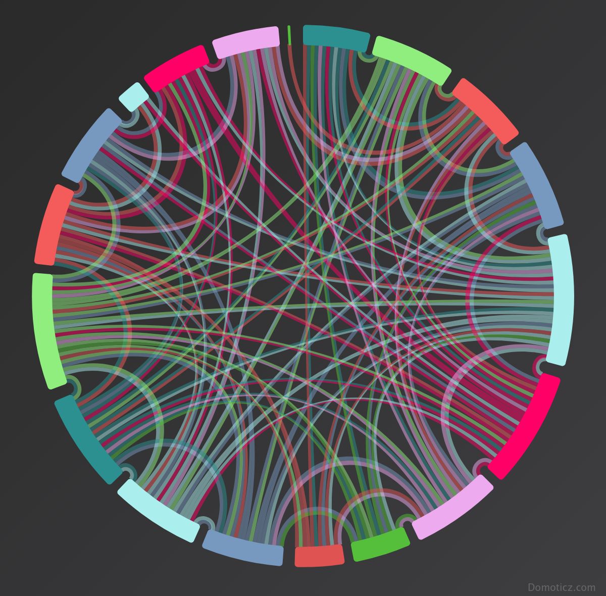

The chart looks like:
The small green thing on top is a dead device, that ghosts around since this morning.
I added nothing to my network, but neighbours could have. Is there a way to track interference?
