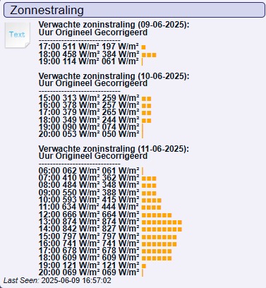

I updated the Sunpower script.

It gives nice information for your local sun radiation expectations.
Sun radiation corrected for your local cloud coverage, high, medium and low clouds.

                "Tijd   Origineel  Geschat  Gecorrigeerd  Geschat  Werkelijk"
                for _, hour in ipairs(data.forecast) do
                    if string.sub(hour.cet, 1, 10) == os.date('%d-%m-%Y') then
                        local original = tonumber(hour.gr_w) or 0
                        local adjusted = calculateAdjustedIrradiance(hour)
                        if adjusted >= 50 or original >= 50 then
                            table.insert(debugLines, string.format(
                                "%s  %3dW/m² %5dW  %3dW/m² %5dW  %s",
                                string.sub(hour.cet, 12, 16),
                                original, schatVermogen(original),
                                adjusted, schatVermogen(adjusted),
                                "--"  -- Hier later je werkelijke meting invullen
                domoticz.log(table.concat(debugLines, "\n"), domoticz.LOG_INFO)
Because of the distance and the one hour prediction I'll have to wait for weather circumstance where there is a stable clear sky or stable cloud coverage during several hours and check where the log output can help me understand.
EDIT
Adapted the script again.
The script runs every 2 hours at daytime.
It compares sun radiation and cloud coverage at hour 0, hour 1 and hour2.
If these are equal we have stable circumstances (even at 15 km distance from the nearest weather station)
It collects WhToday from the inverter at hour 0 and hour 2.
These data (if equal) are stored in a file sun_radiation_impact.csv
The header of the file (the collected data) is this
Timestamp;StartUur;EindUur;Origineel (W/m²);Gecorrigeerd (W/m²);Bewolking (%);WhVerschil
In a few months time the data can be analyzed.
Bugs bug me.
