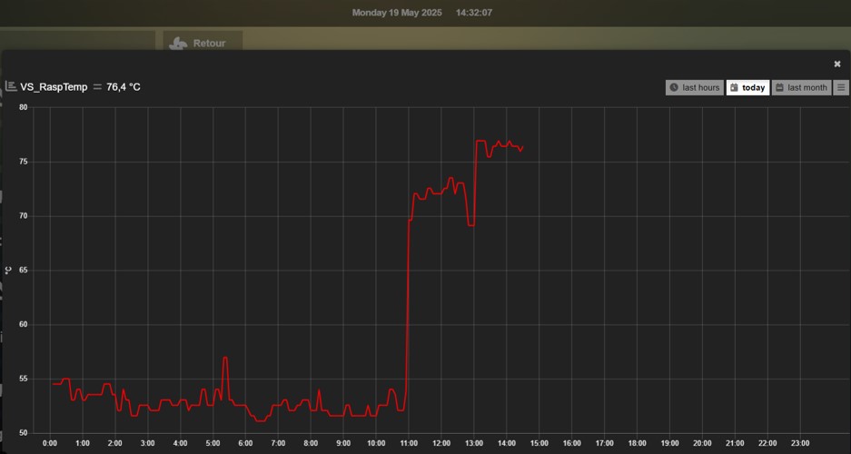

Thank you for the this stable version; however, since upgrading the temperature of the CPU (RPI4) has increased from usually around 50°C to more than 70°C, even after system upgrade and reboot.
Any idea of the possible reason?

Re: [2025.1] after update CPU temp increased from 50 to 70°C
Thanks for your reply.
I don't monitor the CPU load, so I don't know if it did increase.
Currently it is around 60%.
It cannot be due to the environment temperature, as it increased suddenly as shown in the atteched figure.
Such a temprature increase would mean my house burning, which is not the case!
Thanks! It allowed me to identify the application that dramatically increase the CPU load and therefore its temperature.
No, it is meross2domoticz, a PM2 application.
Looking at that application it will probably not work anymore as it has deprecated Domoticz API calls in the js file
https://github.com/mangoose002/Meross2D ... omoticz.js
See the Domoticz wiki how to solve it: https://wiki.domoticz.com/Domoticz_API/ ... and_newer)
Indeed!
I've made the correction in the .js file and now it works fine!
Thanks again to all the guys how helped me.
