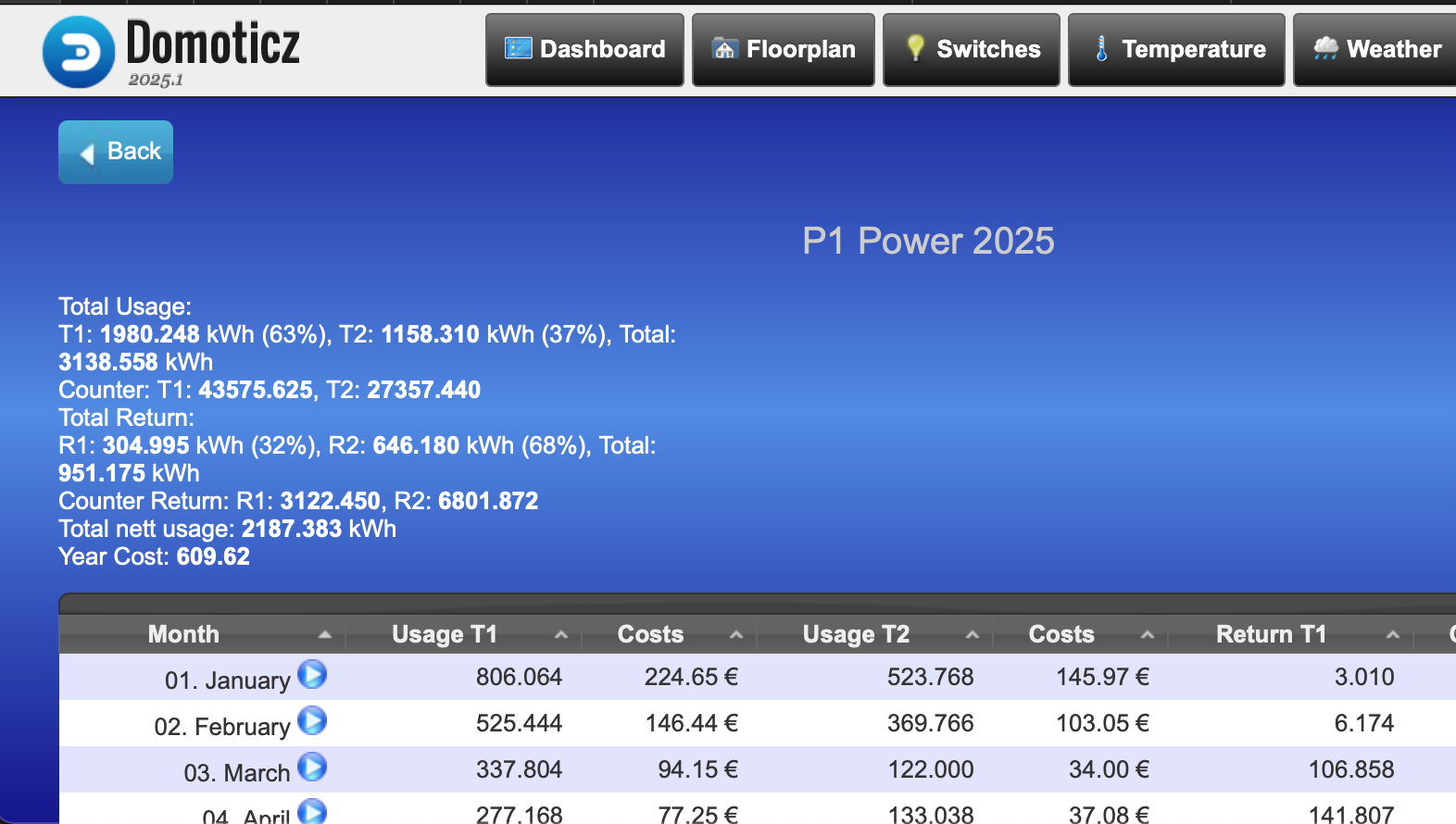

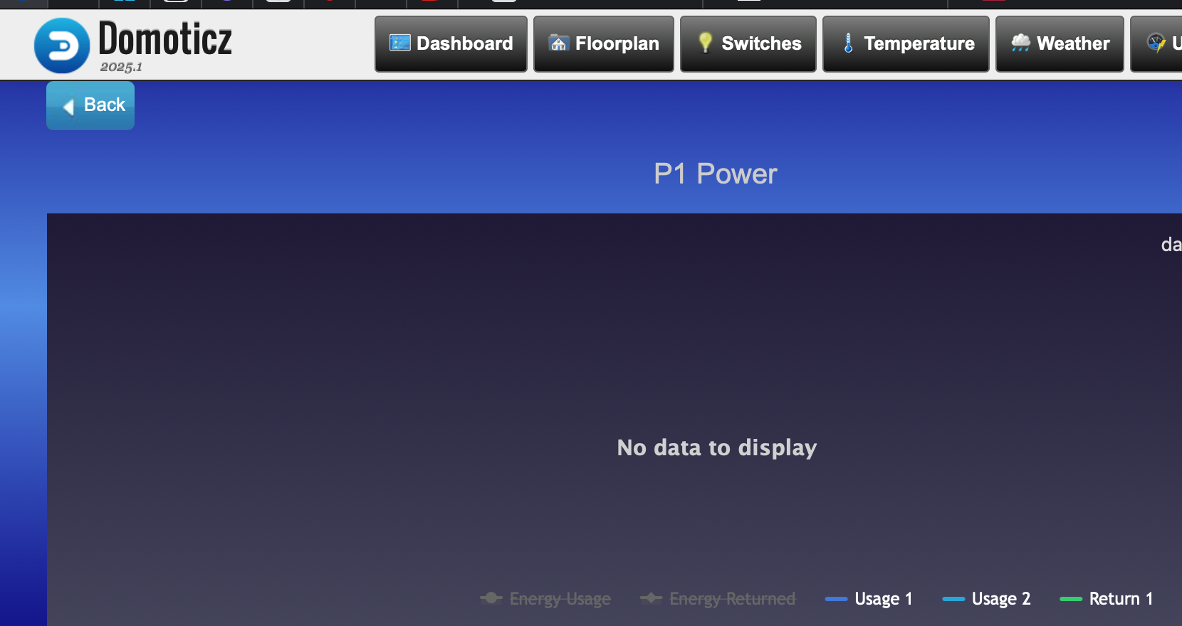

I updated also today (via GUI). Worked fine at first (from windows laptop with Chrome). However via macbook with Safari the graphs do not show: Logs of all devices show "no data available" but data in reports is still available. I restored the database, but issue remains.
New feature was I think that you now can zoom in logs. Might this has broken something (invalid zoomrange or something?)

- Schermafbeelding 2025-05-05 om 23.48.19.png (267.39 KiB) Viewed 3134 times
- Schermafbeelding 2025-05-05 om 23.47.11.png (203.5 KiB) Viewed 3134 times

In Chrome clearing the cache works and data is then visible again. In Safari I also cleared the cache, but this did not solve the issue.

geezer wrote: Tuesday 06 May 2025 0:26 Om my Macbook via Chrome and after clearing the cache it works and data is then visible again. In Safari I also cleared the cache, but this did not solve the issue. Switching to "incognito" also does not solve the issue.
On Safari via my iPhone it just works fine.

As it is working on your mobile's safari, is your desktop safari up-2-date? Is your system up-2-date?
Could you open the browsers development console and see if there are any errors reported in the console?

I have a rather outdated Macbook from 2013 that I need to definitely upgrade (I had other priorities...). Safari V18 is not supported on my laptop. Apparenly the Domoticz 2025.1 version uses functionality that Safari V16.6.1 does not support.

Safari console reports this error: "date value is not finite in DateTimeFormat format()"
I chekced on Stackoverflow and found this information:
https://stackoverflow.com/questions/639 ... t-format-w
The error was probably caused caused by having milliseconds attached to the end of dates being used, which apparently is not being correctly handled by this older version of Safari.
