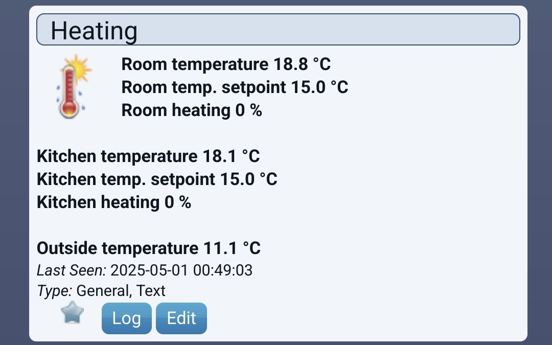

Re: Pushing multiple values to Virtual sensor
You can put whatever you want in a (dummy) text sensor.
