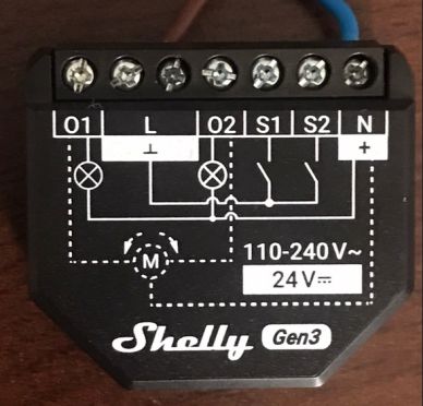

- 2GEN3.jpg (23.81 KiB) Viewed 7133 times
- 2GEN33.jpg (26.7 KiB) Viewed 7134 times

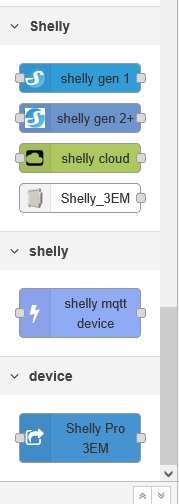

I installed additional nodes related to shelly but GEN 3 is missing.

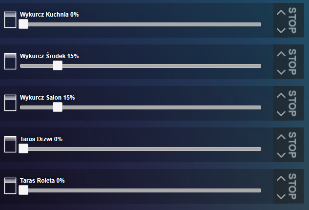

Is it possible to control the roller blinds by percentage in Domoticz?
- nodyShelly.png (14.61 KiB) Viewed 7077 times

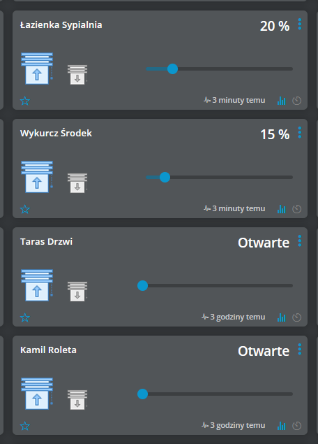

I don't have a shelly GEN 2, I bought a newer shelly GEN 3 model because I read online that the GEN 2 models also have a similar problem with temperature as the shelly 2.5.
I currently use percentage control of the blinds with the shelly 2.5 controller because the blinds are set at different times of the day in different positions.

I see, that you have installed several Shelly nodes.
If you decide not to use MQTT but the contrib Shelly node (https://flows.nodered.org/node/node-red-contrib-shelly), you can leave this node in your palette.
You have also installed https://flows.nodered.org/node/@zebraja ... shelly-3em.
I recommend to remove this one, as it may cause a conflict with the other one and the other one also supports the Shelly 3EM and you do not need support for it now.
You have also installed https://flows.nodered.org/node/node-red ... helly-mqtt. Also that one is not needed.
If you decide to go for MQTT, then we can use the default MQTT nodes. So remove it.
Also another Shelly Pro 3EM node has been installed. Remove that one as well. It is not needed, may cause conflicts and is already supported by the first one.

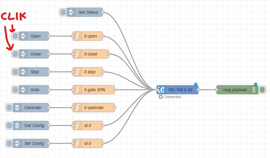

I looked a little bit to your device and its possibilities.
I found an example, which support the first set of nodes.
See:
https://raw.githubusercontent.com/windk ... rplus.json
Can you import this one and test with your device?
I like to know if this example works.
See:

I have removed the nodes you indicated.
Which ones should I remove? The ones in the image remain.
How can I import this https://raw.githubusercontent.com/windk ... rplus.json
import it? How do I do that??

Re: Is it possible to add Shelly 2PM GEN 3 to Domoticz?
With the settings as in the attached image I managed to get a connection with my shelly.
As for the type of connection I have no idea which one to choose I rely on you.

Nice, that means everything is online.With the settings as in the attached image I managed to get a connection with my shelly.
Okay then we go for this node, configured as Shelly 2PM GEN3 (Relay S3SW-002P16EU), as we know that this node works.As for the type of connection I have no idea which one to choose I rely on you.
That is okay.I have removed the nodes you indicated.
1, Go to the link as indicatedHow can I import this https://raw.githubusercontent.com/windk ... rplus.json
2. Select everything (CTRL A).
3. Copy (CTRL C or right mouse button and "Copy") and the code is saved to the clipboard.
4. Go to the "Hamburger" menu in Node-RED and select "Import".
5. The window "Import nodes" will open.
6. Paste the contents of the clipboard (CTRL V or right mouse button and "Paste") and Import the flow.
Test it, if this works for you.

I managed to import the code from the link and I got a working flow. If I click on open or close in NodeRed, it clicks the relay in shelly. So communication with NodeRed works with shelly. Now we need to pass it to Domoticz.
In Domoticz, I would like a switch type with a slider and a precent indicator as in the picture. I also use this type in Dashticz. It controls the blinds using the blinds setting in a given position thanks to the switch with %
Due to work, I have little time to work at home, but we continue working.
