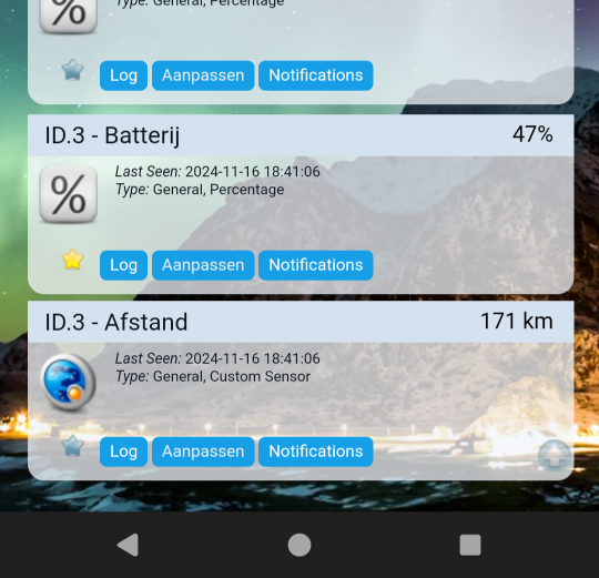

Hi, I made a Domoticz plugin to read my VW ID.3 battery percentage and distance left.
It is not perfect, but it is working. There's room for expansion and improvement.
