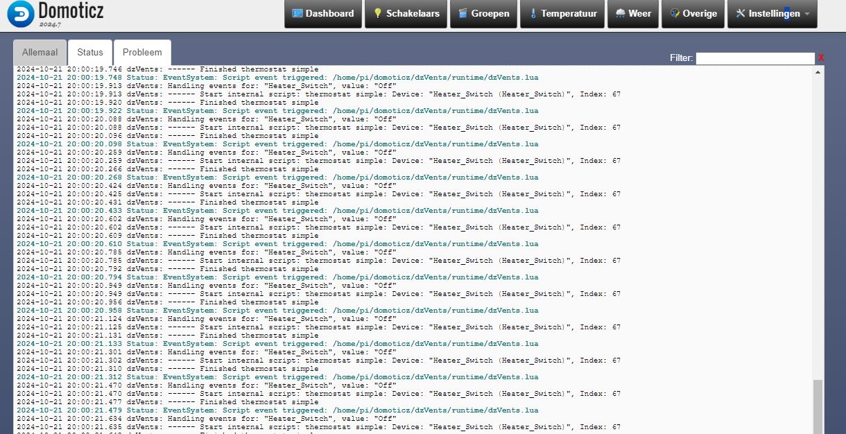

When I check my log from the settings menu I see a constant data stream filling the log.
But that is a very low fill in. once every 20 seconds or so. No important data. Just scripts starting, weather info data and so on.
When I start a Dzvents thermostat script I created the log is filled every milisecond or so with a line.
I am now assuming that the higher data stream could fill up the store location so quickly Domoticz will lock up.But could be wrong.

Hi Walter,
As far as my knowledge goes I switched off all logging options as you described.
Problem of the filling of the log starts as soon as I start the DZvents script as written below and change the setting manual of a "switch".
Without changing the Switch output the logging is regular.
When I want to abort the logging I have to wait around 10 seconds as domoticz seems to be busy still with the logging.
After this 10 seconds the script screen appears and I can stop the script from running.
Any suggestion or should I put this problem in the DZvents section?
Thanks, Paco

- Posts: 7041
- Domoticz version: 2026.3
Re: Domoticz.log location
It seems that one of the triggered devices, probably 'Heater_switch', is updated every second so your script is triggered every second. You could remove it from the trigger device list if that is possible for your script
It could be that the dzvents script is doing the trigger itself due to the switching perhaps add a checkfirst() command option before switching.
dz.devices(67).switchOff().checkFirst()Domoticz running on Udoo X86 (on Ubuntu)

Re: Domoticz.log location [solved]
Got it solved.
Paco
